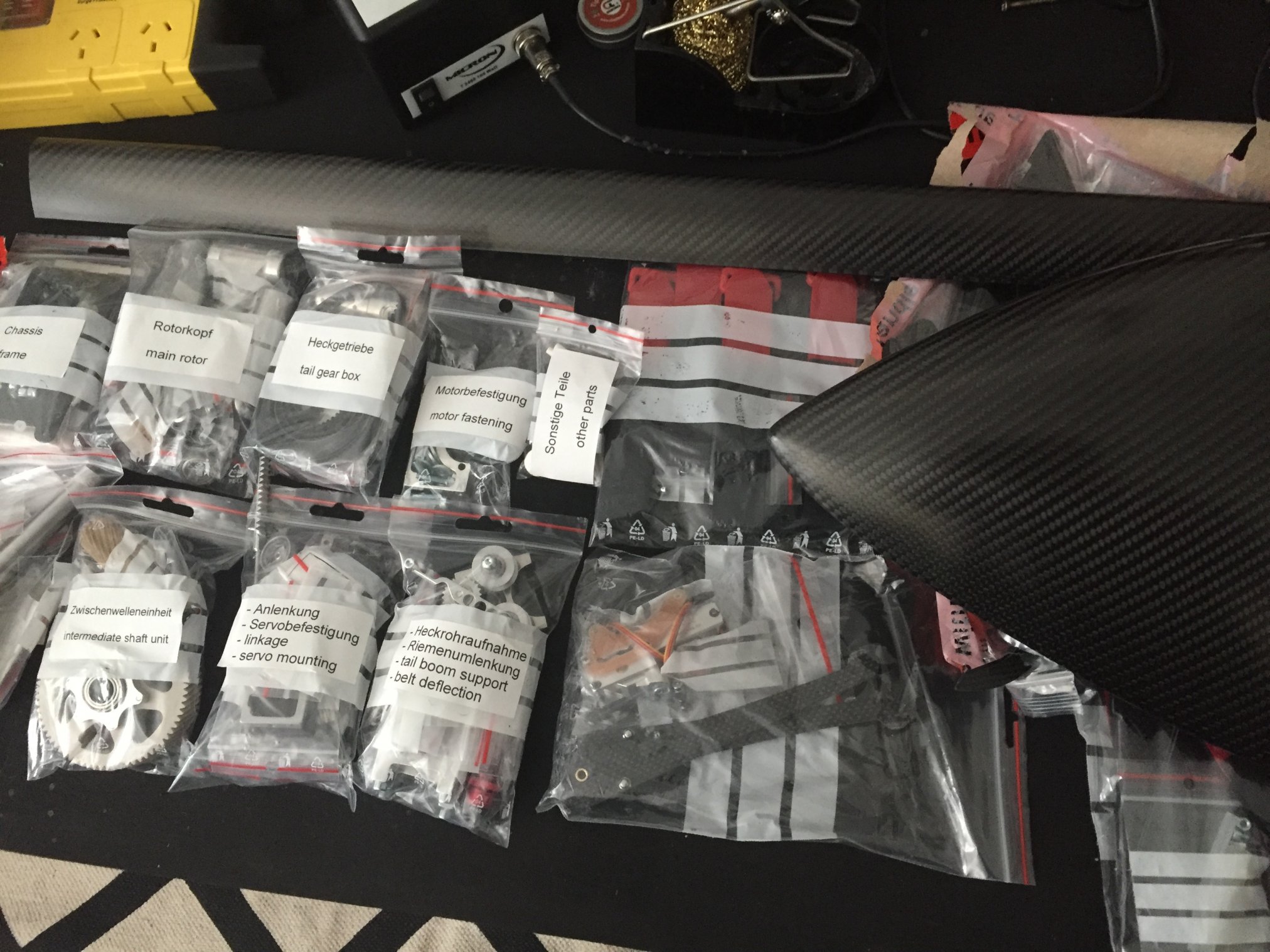

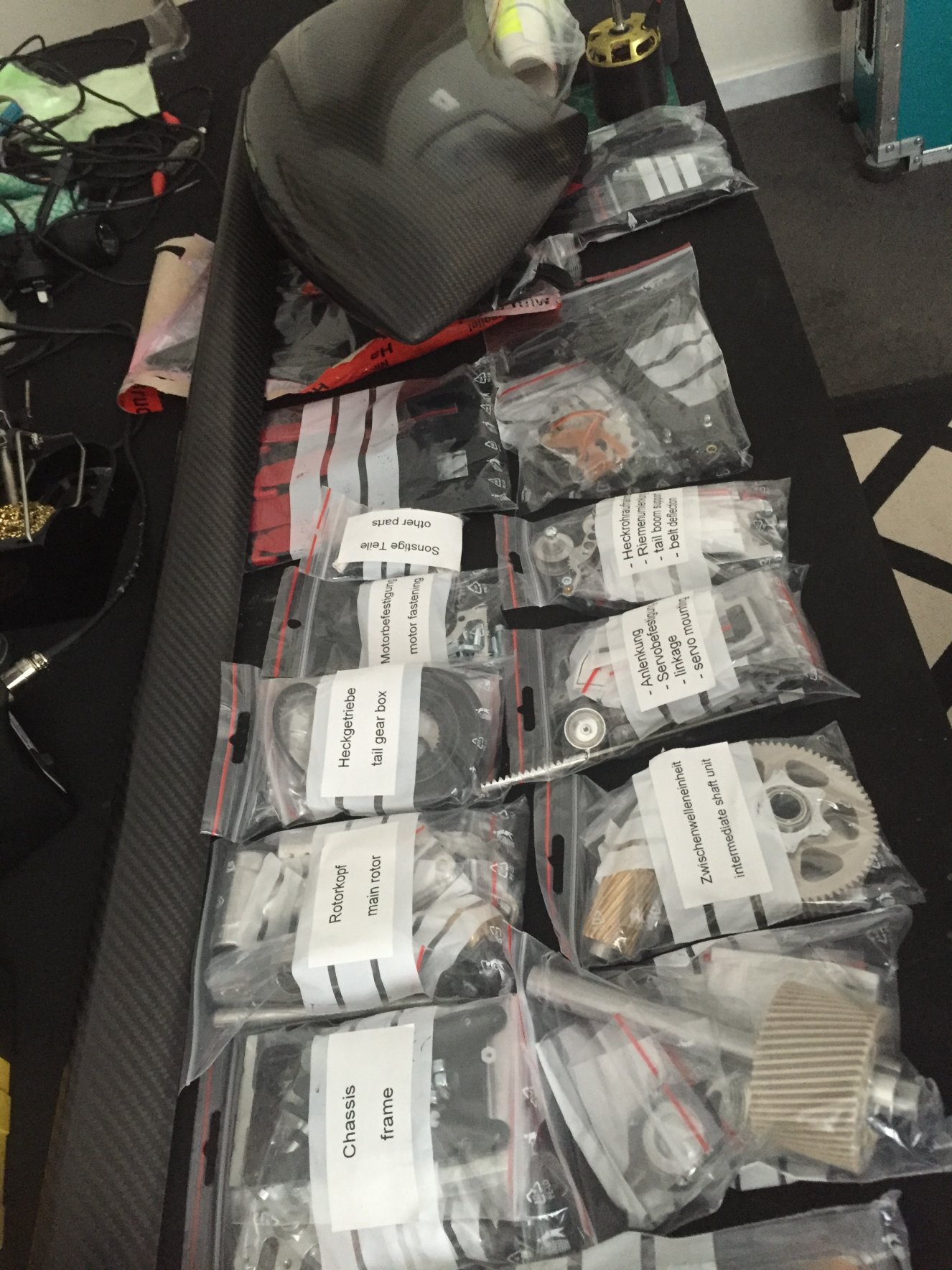

    The following thread will show the build progress of my new Henseleit TDR2.
    This will be a little slow going, but I hope to progress thru it over the coming week before I head back north for work.

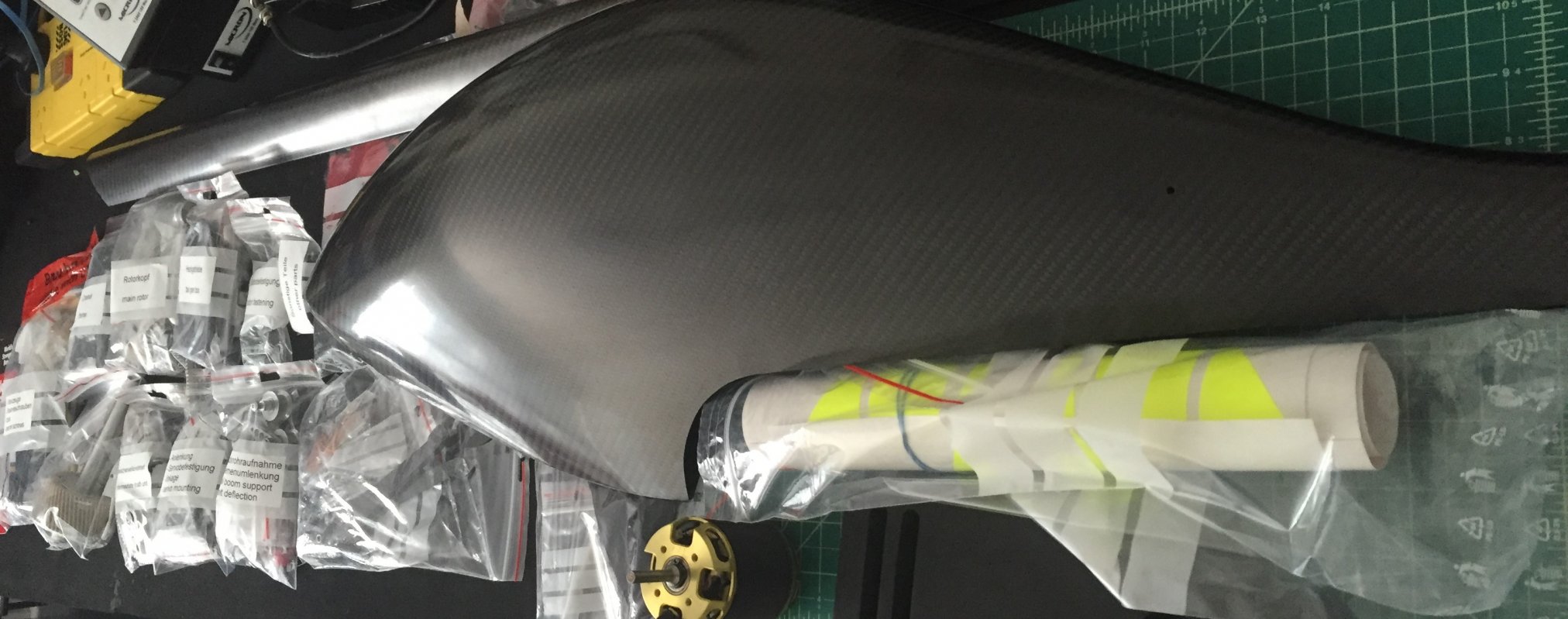

    It comes packaged in two parcels, as a way to avoid added tax cost due to high value. As I did not purchase any electronics with it, I just got a box with everything and the blade caddy in a separate envelope (700euro blade caddy :p ).
    The canopy is sensational, so glad I paid a little extra for the CF canopy instead of going poor with the GF version. And the CF boom is out of this world! All the mechanics are in labeled section bags, matching up with the 108 page manual. Its recommended to not open up and bag until working on that section from the manual, as this being a high-parts count one would hate to loose track! :)

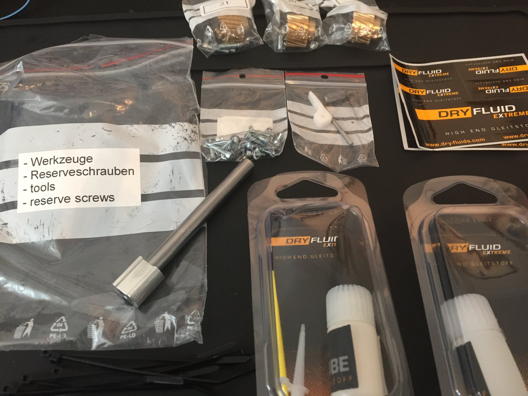

    The kit comes with a bag of extra bolts, tools and Dry-Fluid bottles. And let me say that at the rate this kit is impressing me - I'm going to be using all the DryFluid lube on myself!!! :eek::D:p:p:cool:

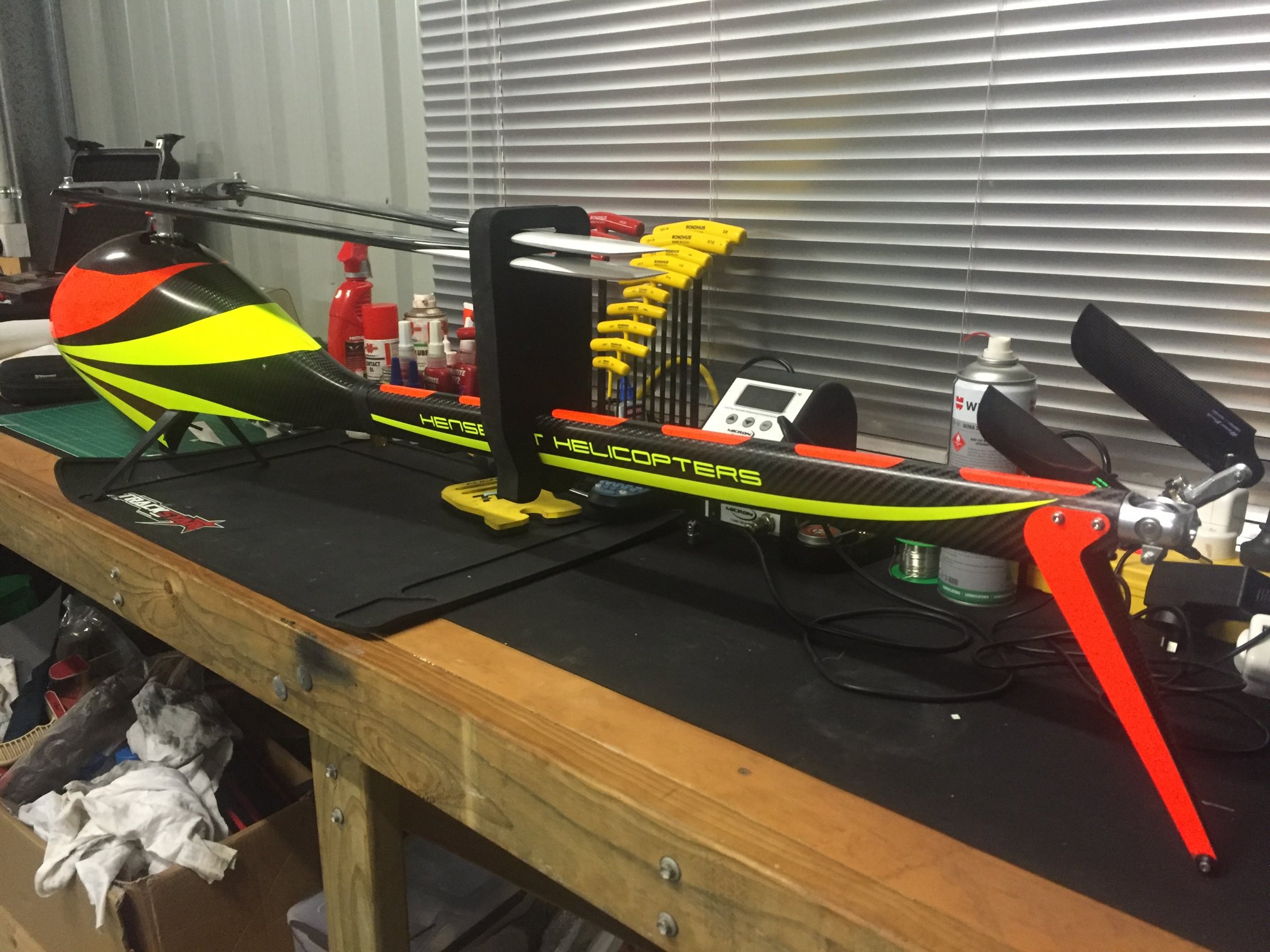

      If your wanting a stripe on the boom like mine, just get yourself a Banshee and apply the canopy stripes to the TDR2 boom ;)

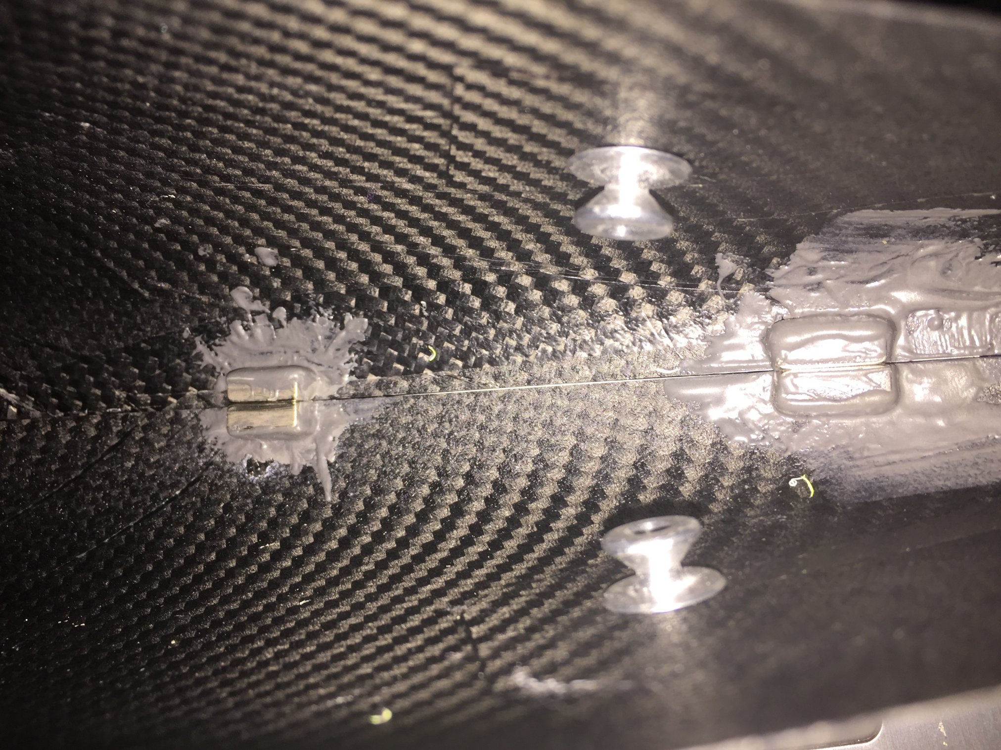

      Actually did this way back during the build, but didn't post the pic due to thinking I'd get slammed for my messy gluing efforts... ;) But anyway, more info and ideas posted the better :)
      Glued in 10x5x5 N42 rare earth magnets to the canopy back top edges to keep the meeting point closed during flight. Glue used was "JB Weld". Sand the faces of the magnets and CF canopy to be glued to ensure good contact. Fiddly work but helps with the application of the canopy.
    11. ChopsyWA
