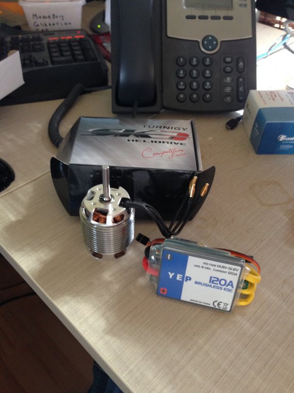

      I have an E6, I had a scorpion 560kv 4035 and a castle 120HV esc. Let me say right now it was a disappointment, it was not on song, and both the esc and motor would come down red hot (5 flights old). So, on flight 6, I pushed it a little, had a thermal cut out, and a forced auto. Checking the logs it was only drawing 40 amps, no wonder it was a pos. I reprogrammed the esc that night (settings seemed OK), but I heard a crackle when connecting the battery. I thought it was a battery spark. Next day I went out, throttle hold off, and it was a dead as a doornail, so I took it home, soldered up a spare (brand new) CCHV120. Excited I took it out to the field. Stick forward, nothing. Frack, must be the motor. Well I spat the dummy. So I got this
      I know I'll burn in hell, but hey, I have an open mind, I'll try it and give my feelings. Now THAT'S how you do a heli on the cheap @Manyc . Motor is the same spec on paper as the scorpion HKIII4035 560Kv and it was $63.99 - go figure.
      Well there is only one way to find out! And that is to try... but if you try based on other peoples experience then they have done all the hard work for you usually. The Yeps have a reasonable reputation from what i understand, i dont know about the motor. I think you will be fine!

      I think @utrinque has used this combination of motor and ESC quite successfully...
      and in a 600 it should have a bit of go
      I think it will kick ass. I flew a 4035 on a goblin 700 set up as a economy smak machine and it had enough go to be pretty impressive. So on a 600 it should rip the bearing blocks out if you pump the pitch hard enough! (lol)
    11. utrinque
      I used YEP 120 HV with SK3 motors 480kV and 560kV. I prefer 480kV it has more torque. I assume 560kV should also work fine.
      If you decide to program lower throttle curve turn on free wheel in ESC.
      Keep in mind 700 can burn 120A ESC at high RPM. Start with lower throttle and check temperature of motor and ESC after each flight.
      At low RPM I am flying 800 on 120A HV.
      Low PWM can overheat motor, high PWM can overheat ESC. Set it accordingly.

      Thanks for that, I'll go a pretty high HS, STNT 2 maybe 2400. How often do you oil / change the bearings on these guys? It's the first time I've gone HK for heli motors

      2400 is probably to high for SK3. It will burn. I can be wrong. 120A ESC is also to weak, use 160A.
