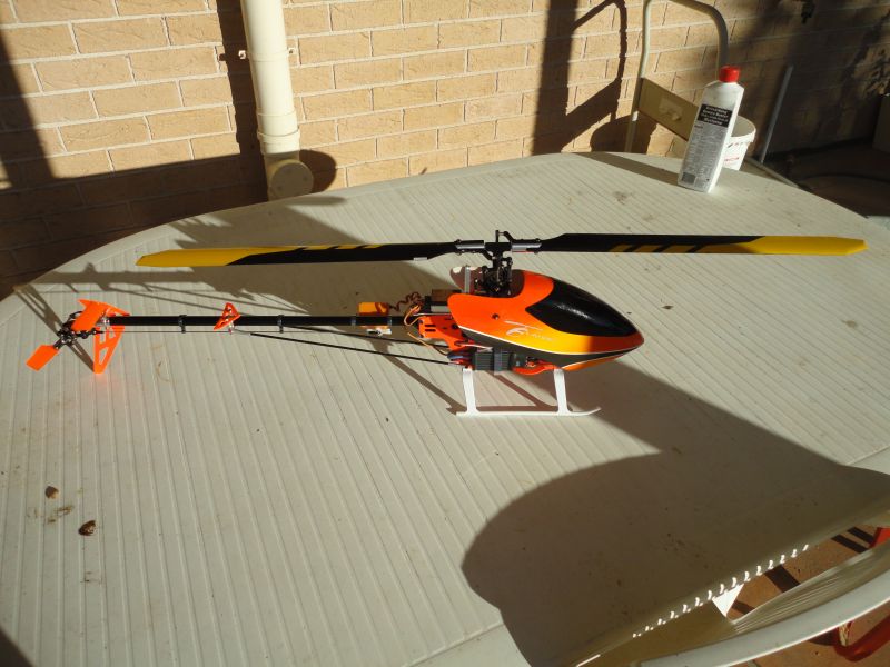

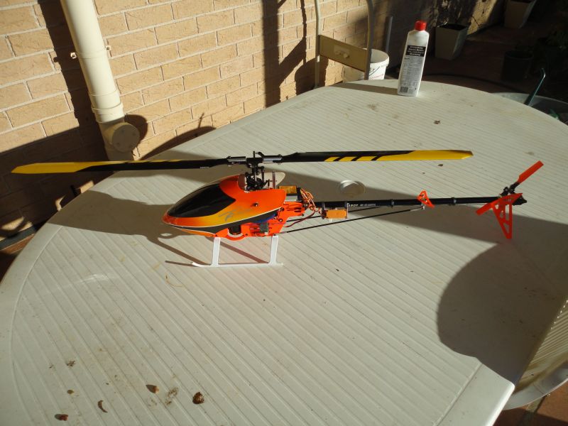

    1. jockstrap
      Stick a $30 kbar on there with some HXT900 analog cyclics, A 15158A tail servo for $8 and a HK RJX head for $15 and you'll have your 3D machine!!!
      This is how I know!!! (PS: has a beastx there in the pic but has a blue kbar now and flew much better with the kbar)
      Also, those pics were of it stretched but I liked it better normal.. was only stretched for a little while... Still have the same heli.. have analog hitec HS65's carbonites on it now but had over 300 flights on it with HXT900's... it's also been 6S all of it's life..

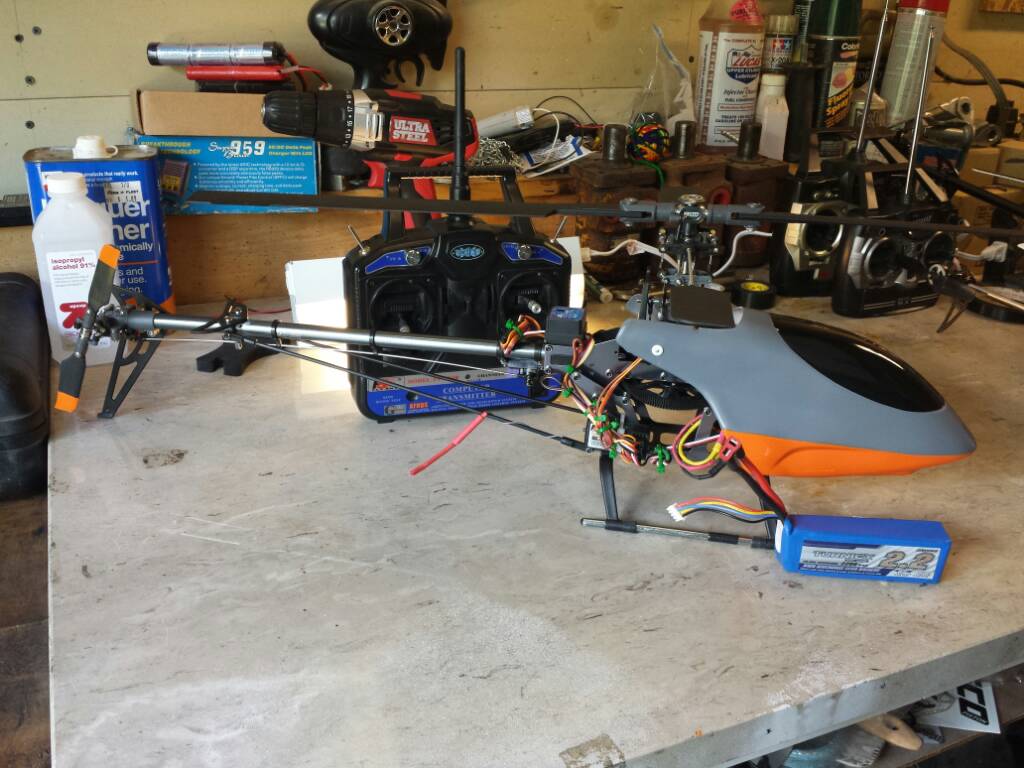

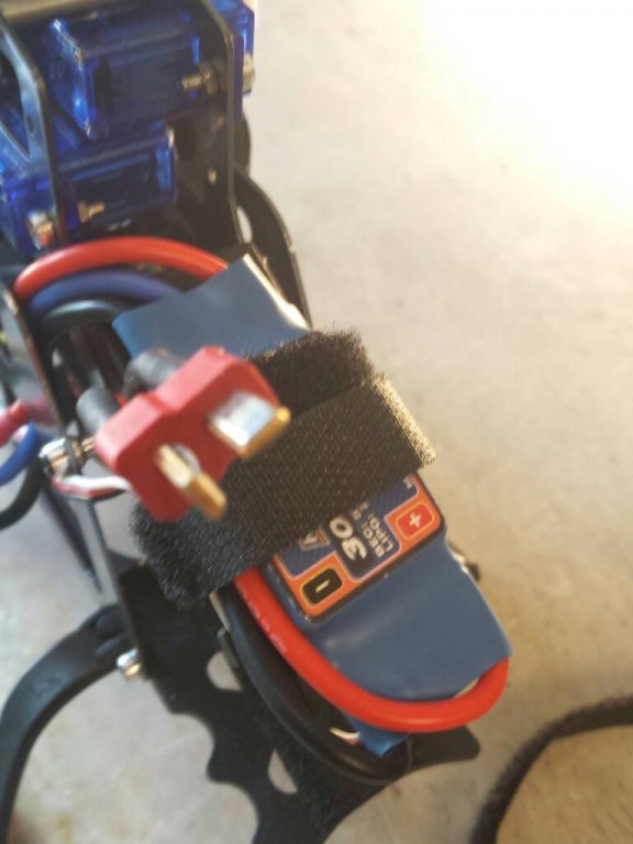

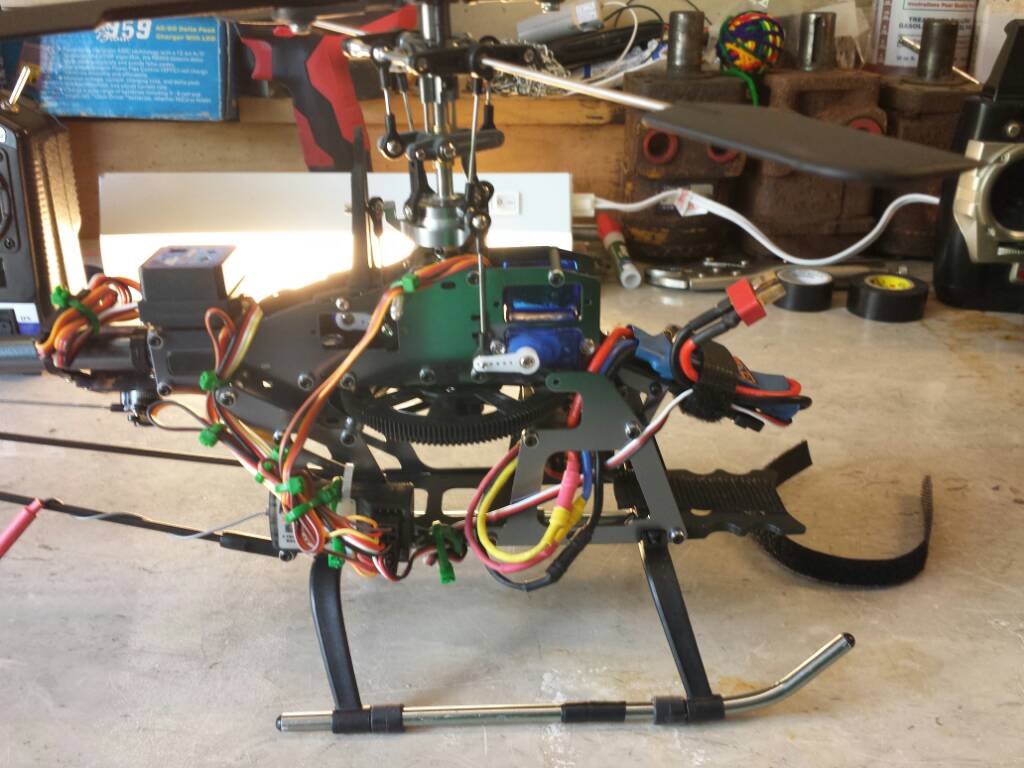

      Just a couple of promised pictures!!
    14. Rcheliguy1242
      Rcheliguy1242 New Member
      Aug 31, 2014
      16
      2
      What do you guys think.?
    15. simon
      I think you are going to heaps of fun with that thing, even @Crash Heligod will probably pay you a visit (he's like that) after a whoopsie, go fltybarless, paddles are a drag. It's all good from here

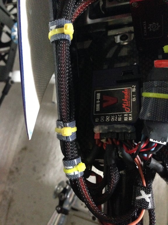

    16. simon
      I'd also put some fury velco where the wires are coming over the frame, or @Crash Heligod will see you sooner than you think. I also think it's a good idea to put some velcro around wires before zip tying, this stops the vibration turning the zip tie into a knife - no good in the air
      Like this
