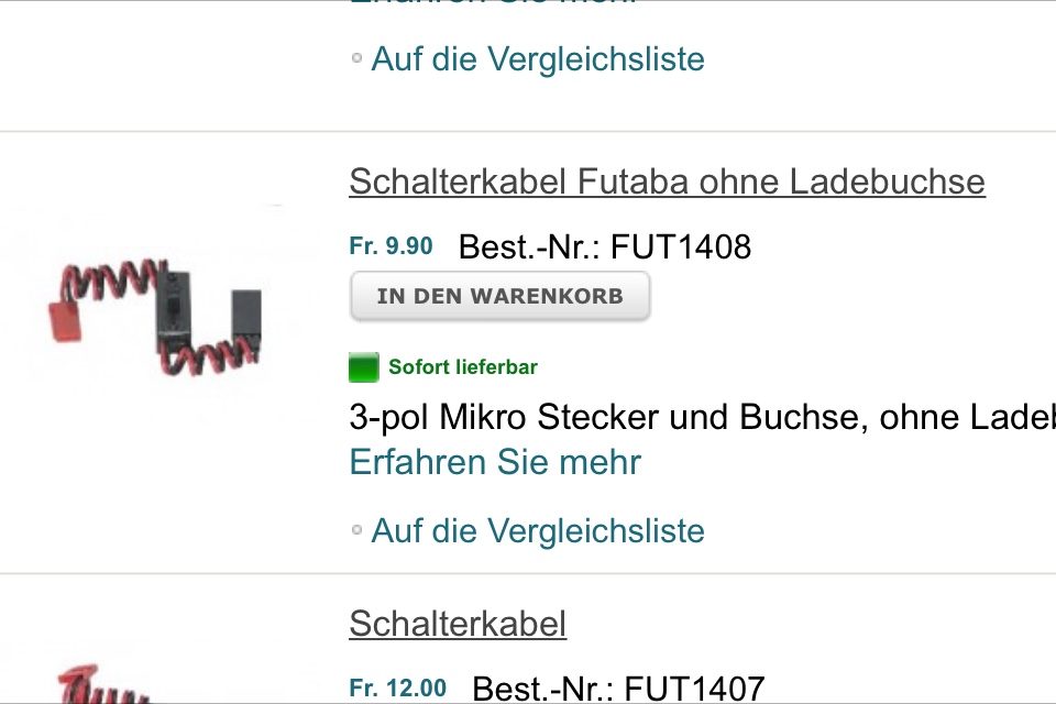

      I will use this.. So I dont have to plug the battery in directly anymore. ImageUploadedByTapatalk1414183544.673036.jpg
    5. Manyc
      Ahh the good old switch.. I have a few of those... the reason I went the way I did was it has 2 wires coming out for redundancy and power. Also if the switch fails it fails to on.. and it uses a standard connector so any pack can be a flight pack...
      But I ran a version of that switch for a long time
    6. iggy
      Its a nice feature that iz fails to on. But how big is the possibility that the futaba switch i posted fails..? i think a servo or a esc fail will be 100 times oftener..

      Does somebody knows how much amps the Futaba switch I posted above can tolerate?
      Futaba could not give me an answer. What a shame..
