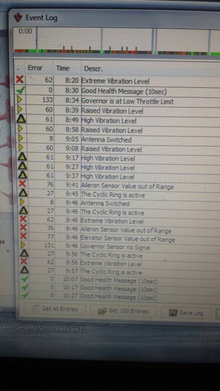

      Here ya go crash evidence of your handy work and there is no known way to read the log backwards.

      Dear Feral.. If you start reading the log backwards from 10:27 to 8:20. the last entry (which is the first in the log) is extreme vibration level.. You may apply logic to the situation and state that its allways like that when the heli spools, but is it in this instance? I sometimes like to shake things up a bit.. Thank you for the memory Muah ha ha ha...

      Hopefully he'll tell me what aileron sensor out of range bloody means
    11. HeliGods
      I think error 62 is a big hint, lol

      I think I you look up error 62 it says THE GROUND. lol
    14. feral
      Yep id say thats wen it bit the dirt all good health messages while it was laying on its side sulking
    15. HeliGods
      Check your tail out dude, this is not the only cause, but can be a lot of the issues with vibe's

      I was thinking main shaft bearings. The out of range messages were the impact, and yes, the good health messages were lying on its side, sulking

      Turns out my torque tube was rat shiz aswell I can hold the tail and turn the head and the tt slips then grabs again ill be slapping a set of main bearings in it aswell
