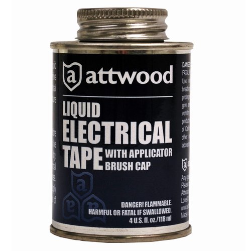

    4. Geena
      They don`t prevent them from touching the frames, but I dab a small amount of liquid electrical tape on the wires where the clamps are. No problems so far. :)
    5. hgnimda
      Thats an excellent idea! Liquid electrical tape. I have never heard of it before. Sound like good stuff.
    6. Geena
      I get it from the hardware store next to our work shop. It`s good stuff.
    7. MadBird
      I haven't used it before, but I have heard if people using a bead if it along the edge of their CF frames to prevent chafing of the wires. Jaycar has a similar product here in Oz.
    8. Radar
      Yep I use zip-ties and Velcro to protect the wires. But liquid elec tape would be a great idea, I have been using it for a while but not to hold down wires on my Heli. Great idea @Geena
    9. hgnimda
      Does anyone know of the same sort of stuff that @Geena is talking about in AUS? I think it would be handy to fix nicked wires etc..
