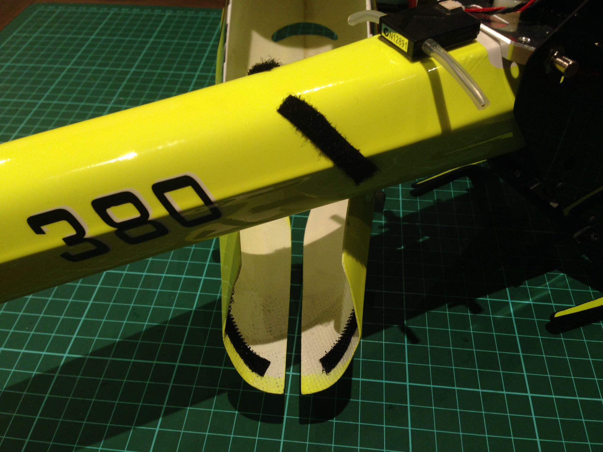

      After seeing the aftermath of @The Dude's canopy dislodging from his 380 today (magnetic canopy mounts let go during backwards maneuver) I have added some velcro between the boom and canopy. I have only put a small amount for a start as I don't want to make it too hard to remove the canopy. Hopefully tomorrow I'll get to run a couple of tests to see if I have applied enough.

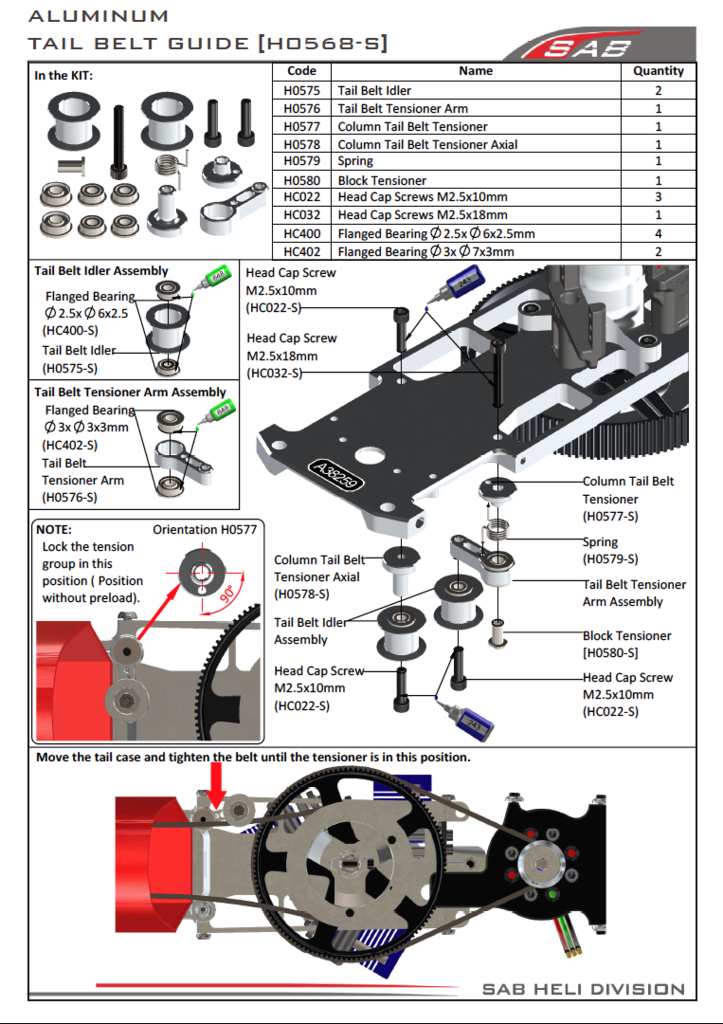

      @Kyle Orrock installed the belt tensioner into @3dmick's 380 on the weekend. I didn't see it fly, but on the bench it looks like a sweet piece of kit. I'm sure those two will be able to comment on it's performance.
    4. The Dude
      Get one... It's that simple ! Functional bling... Seems to make the tail a bit smoother.. I was having some blowouts at times but now none. And anything that helps keep the belt on is a good thing
      • Useful Useful x 1
    5. MadBird
      It's not shown in the stock photos, but there is a spring included as well. It's not strong enough to 'tension' the belt, but it will help pick up the slack if a bit of belt slap occurs during hard maneuvers.

      This was my first ever build from scratch. Not so experienced, so is there an easy way to install the belt tensioner? :)
      ive had a quick look at the instructions on the sab website, just dont want to have to disassemble more of it then i have to.
    7. MadBird
      Just need to drop the belt off the pulley and use some tweezers or long needle nose pliers and hold your tongue in the right position.
      Ask @Kyle Orrock to install it for you! He installed mine and just about everyone elses in Australia! Seriously though its a worth while addition if your going to run high HS or hard smak

      Here are the instructions.
      Umm at the moment he is in QLD... If you are near MRCHC we could look at it for you but it would (at this stage) have to be on the weekend. What area are you having trouble with? See @MadBirds instruction above. Start by putting in the bearings in the belt guides first. Use the green loctight sparingly as shown. Do not get any in the bearing. Drop the belt so you can get access as shown in the diagram.

      Speaking of green loctite (638, 648)... Make sure that the bearings in the swash follower/radius arms are retained with it or else you will probably develop slop in them at some stage.

      The instructions look simple, it was more about easiest way to access the area without pulling too much apart.
