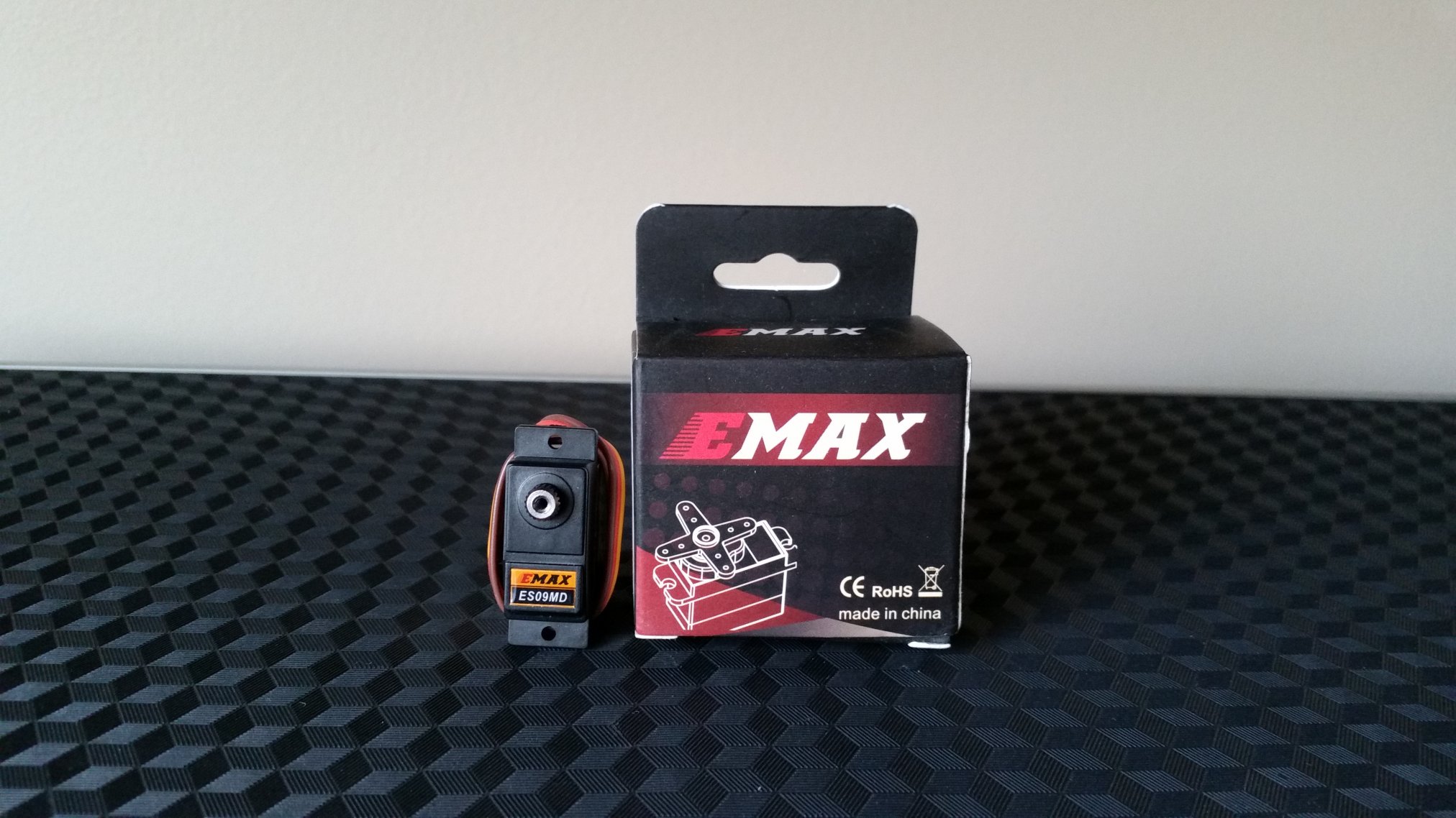

      I've been watching the Heligods Youtube SIM Tutorial videos, religiously. I've also been hitting the SIM religiously. I just hope all this SIM training pays off and hopefully I won't need any training wheels. Here's hoping:( and praying it will all go well. I gotta start this build, i got the cyclic servos Emax ES09MD. I need to check inside of them for grease and see if everything is ok and working well. I'll post some pics hopefully later on today.

      I just opened up a one of the cyclic servos, and I thought it was all metal gears as it said, but it turns out one of them(small one) underneath all the gears, it's plastic. Also there doesn't seem to be any grease/lubricant, perhaps they dried up? I applied some lithium grease in the bearings and metal gears, I will be doing this to all of the servos. Going to test them hopefully sometime this week(if all goes well) to see if they work well @ 6V. Hope they don't burn out. That small plastic gear worries me a bit, as I think that will be the weak point of this servo on an event of a crash. I think the cheap price for the set of these servos made me buy them. But after these I'll try something else.

      On the servos, a plastic gear wont hurt as long as its close to the motor on the high end of the reduction gears, the metal gears are more important close to the output shaft where all the torque is.

      Yeah, you described my servos exactly. I see. Thank you

      Your servos should work fine. Full metal geared servos aren't indestructible as I found out, the one I killed was the gear next to the output sector gear. The smaller gears were okay.

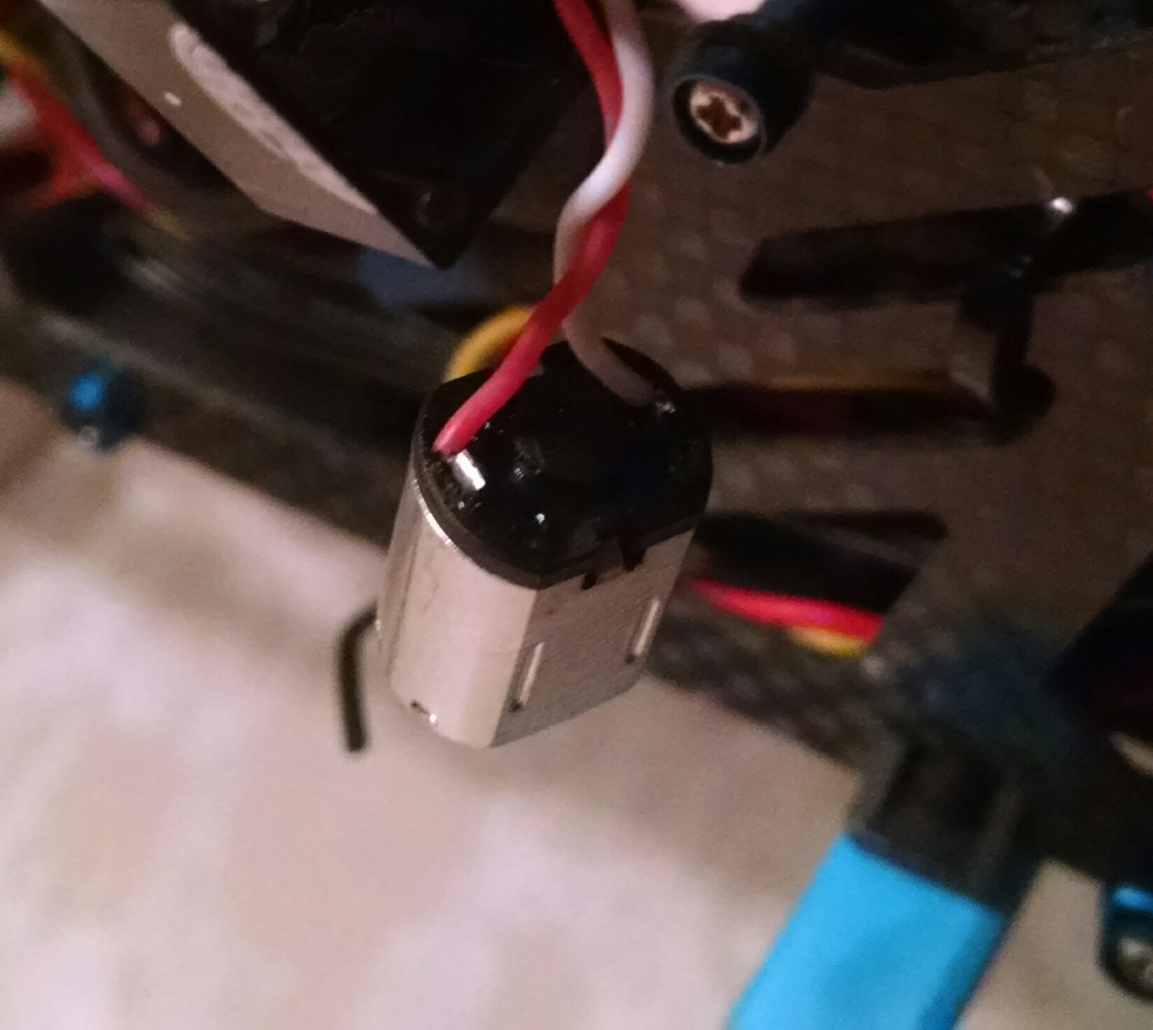

      The ones I'm using now work, but another one (not the one I repaired) has developed a slight jitter since the last hard crash last week. It went in pretty hard..... I'm amazed these cheap servos survived as well as they did! If I can avoid the crashing, they should last longer. :p
    19. Beaver
      I compared the specs of your servos to the ones I'm using. They seem to be close to the same specs. I'm not sure running them at 6 volts is such a good idea, they will probably last longer at 5v. The difference in speed is negligable. I recently bumped up to 6v and my servos seem to be running a bit warmer than they should.
      The first batch of these TGY MG90s (Tower Pro with Turnigy stickers) are either older versions or counterfeit because the ones I just ordered from Hobby King are listed as having coreless motors. The motor pictured below that I just replaced a few days ago is NOT a coreless motor. IMG_20160202_175630.jpg I can't wait to get the new servos so I can compare old against new. Either way, the old ones have to go away because they are no longer reliable after those 2 hard crashes I've had. :confused:
