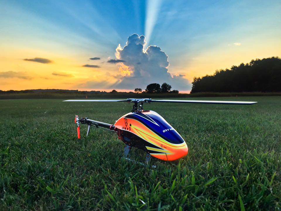

    The informer has found some information from Luca Invernizzi regarding production of the OXY2 and Oxy4. Production fort he OXY2 is starting next week (15th) so see below for more information. 13934985_1762884217261016_3081465170934200379_n.jpg
    From Luca Invernizzi
    Ok guy.. is time to say.. I read a lot and now is my turn.. lol.. during and after ircha I take with my stuff and consultant the waited decision..
    Oxy 2 is the next.. next week we start the production..
    Oxy4 is now delay to February.
    i dont want spend to much time to explain why.. but main reason are the request from you all and the right product for the indoor time..
    Now lets explain some about Oxy2 and stop all confusion here or there..
    Oxy2
    - 190 mm blade on std kit
    - 210 mm blade on stretch kit
    - dfc plastic rod.
    - Belt drive system oxy 3 no one way on std kit optional upgrade one way system.
    Optional tail pulley ratio.
    - Oval tail boom no boom support
    - carbon alu plastic main frame with new servo layout system never saw before.. 120 deg diagram with full direct accessibility to each servo.
    - Lexan ultralight painted canopy optional fiberglass.
    - head speed min 3500 max 6000
    - motors from eox 1611 5100 kv for sport fly up to 1912 3600kv (t rex 250) or max eox 1914 4000 kv in production.
    - esc min 25a max 30a
    - battery 3s 800 / 1000 --- 4s 450 / 600
    - servo cyclic :sub micro servo 180cfx type.. . kst245 mg full metal servo or MKS similar case.. NO MICRO SERVO compatible (t rex 250 or oxy3 for example)
    - servo tail. For sport fly same cyclic for smack 3d different option 180x tail servo 6030 or align savox.. but are heavy.. Tareq and Rasmus choice is the 180x tail servo.. just a note in mine heli because no vibes pass 1000 fly and many crash.
    - fbl u brain u ikon mini brain mini ikon spartan microbeast y280 ..
    - ready to fly weight around 250g depending on electronics..
    We estimate to release it by November possible early..
    Retail price will be around 210 usd for the kit with 2 set of main blade and 2 set of tail blade.
    No need start say about price.. I say.. who need a reliable mini kit with amazing performance.. the oxy 2 is the heli.. for who no need performance maybe other RTF option are better.. and everyone are happy..
    I dont want stole customer from other brand. I want introduce heli performance and feeling not see before.. oxy3 give a signal.. oxy2 I am sure will change the way to consider a mini..
    Is impossible made heli that will made everyone happy.. oxy is expensive products but dont made me ritch.. but happy about the performance.
