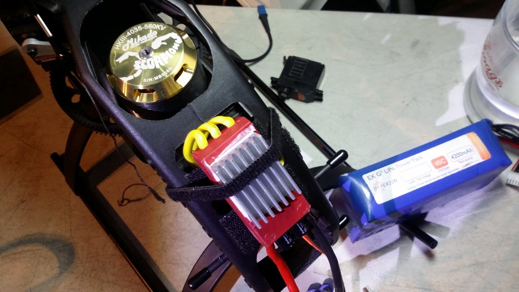

    Another project I'm in the process of creating I have cyclic servos and tail servo
    motor is going to be a scorpion/Mikado motor out of a friends old logo 600
    Just need a speedy might be a CC120 hv need to find out suitable pinion as I'm not sure.
    Here is where I'm at so far looking forward to flying this baby.

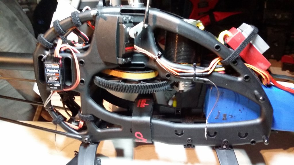

    1. mr_squiggle
      Well you did ok then didn't you! That's a Quick UK tail with 95s so that's good.
      Check the thickness of the main gear before you fit the counterbearing. The SX one is 13mm thick & the regular one is 11mm if I remember correctly.
      Better cut the motor shaft before you cut loose on the Asahi super dry.......
    2. 5Fidy
      Thanks for the heads up mate bit hard to fly with a severed finger.
      so all is good you think it's my first logo and it's always good to get
      Info of someone who has had experience with these puppy's
    3. mr_squiggle
      Looks good from here! The main gear should have a little big of up/down float so it stays centred on the pinion so don't shim it too tight either.
      Set the pinion position without the counterbearing using short motor bolts then fit the counterbearing. You can do it all together but it's painful & you'll be practicing your swearing.
    4. 5Fidy
      Thanks for the tips buddy also I don't think I will have to train the motor shaft
      Cause I even noticed in the pic I took the shaft is sticking out about the length of
      the motor mount and also it came out of a friends Logo 600 but was not even spooled
      up... thanks again

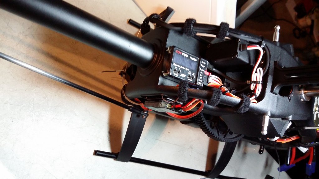

      Let's get it on ok they are in just need to rout the wiring the the CGY750

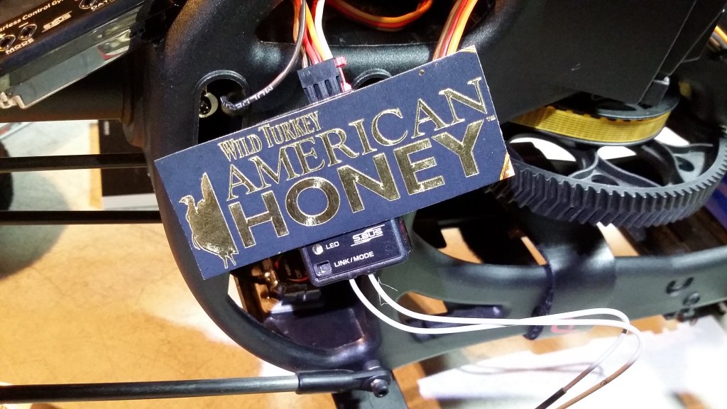

    10. Manyc
      And use the lemon receiver now... that's dsmx
      Just perfect, although this configuration may tempt the BEAST
      Oh SNAP! a Lemon receiver.. @Crash Heligod will be impressed! Then the logo build would definitely fit the category of Extreme!

    14. 5Fidy
      Ah my friends they were all out of fruity receivers so I got something SAWEEEEEEET.
      They do S.BUS as well. Who would have known....... lol

      Nearly there nearly there. Check out that wiring simon

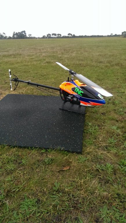

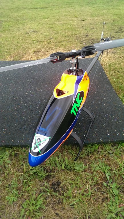

      Well I have to say the maiden flight went perfect the heli is so so quiet. Boy
      You can tell it's light In the air feels so punchy very gracefull. Have to say it comes
      close to the best heli I have ever flown. Very very happy and is only Goin to get
      Better with more tuning of the CGY750. IMAG0187.jpg IMAG0186.jpg IMAG0187.jpg IMAG0186.jpg
