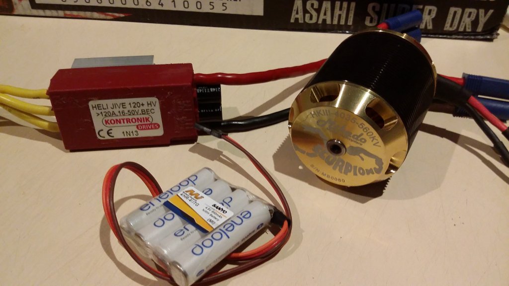

    Another project I'm in the process of creating I have cyclic servos and tail servo
    motor is going to be a scorpion/Mikado motor out of a friends old logo 600
    Just need a speedy might be a CC120 hv need to find out suitable pinion as I'm not sure.
    Here is where I'm at so far looking forward to flying this baby.

      should be able to aquire that speedy of Mark this weekend
      Godfather you must notify him for me. Thank you............

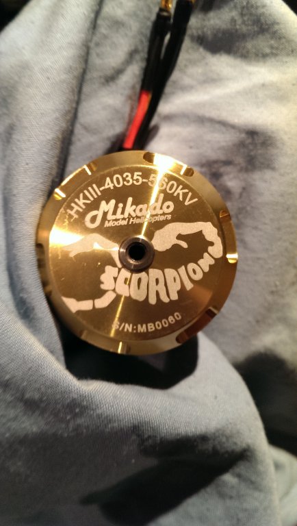

    3. 5Fidy
      Goin to pick up the motor for it tomorrow I think it's a 560kv just need to work out what
      pinion I need. I think I want to run head speeds of 2000 and 2100 that's just a rough guess at the moment.
    4. Min
      Min Well-Known Member
      324
      249
      11T
    5. mr_squiggle
      If running 560kV I agree with Min, go the 11 tooth pinion.
      If you need a speedy let me know. I have a CC Ice2 120HV with USB & castle link that I was going to out on my 600SX until I bought the Scorpion 130......
    6. 5Fidy
      Thanks min and squigs just picked up the power plant and dam I have a 13t pinion
      Need a 11t thanks for the advice guys. Also thanks squigs I already have a cc120hv that is Goin to be
      implanted into my new baby. Cheers guys the motor even has MIKADO on it wicked man

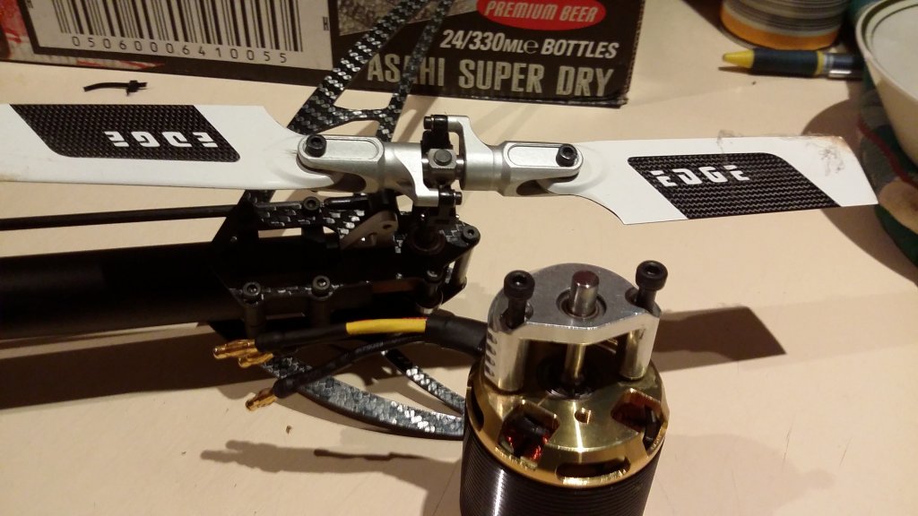

    7. 5Fidy
      Yes guys you are all right 11t is what I need and one other thing.
      That would be a CGY750 cause I picked these up this afternoon. Hopefully
      this weekend it should be up for a hard core hover maiden flight. Then some BIG AIR
    8. mr_squiggle
      Hmmm, no counterbearing support. Might want to keep headspeed below 2100 & not too much pitch if you're going to go mental with the sticks. Running 600 or 620 mains & 95 or 105 tails? Recommend 600 & 95 without the SX upgrade.

    17. Min
      324
      249
      600 mains and 105 tails with no more than 2000 headspeed means you wont really need a counterbearing. Youll be stripping gears every flight if you go too hard without a counter bearing.

    19. 5Fidy
      Hey guys this is my thread...... lol I'm loosing it here with fits of laughter. Back to the point these are
      what also come with my $200 Logo
      THE tail blades I'm sure are 95 mm and the mains I have are edge 603. 2100 rpm will be my max head speed
      2000 will be my comfort zone......... Think I should be right with this what do ya reckon?
