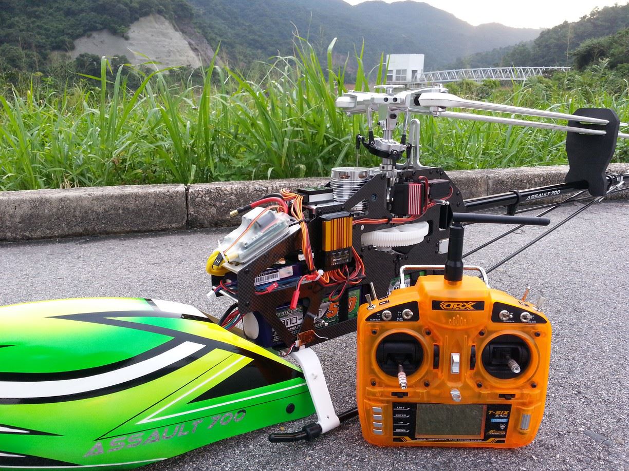

    I fly this beast since January. In ten months I crashed it only once. It prooved to be very reliable heli with some Align parts. If you type in Google "Gartt 800" you will find whole story of this project. Now I can do rainbows and tic-tocs with this 800.
    I am not the only one. My friend Benji after reading my thread on Polish forum also built 800 based on Assault 700 kit. He also flown it for months without issues. Actually idea to stretch it to 800 was mine but Benji was first to maiden it with 800mm blades.
    Idea was simple. Get cheap frame. Put $30 Align stretch kit including longer boom, TT and tail push rod.
    I am using 4.2kW Gartt 700 motor and it is strong enough. Lately Gartt released stronger 4.5kW motor for just $50.
    I was able to get this kit for $175 without canopy directly from Gartt. I ended up with four airframes. Two of them are now 800s and flying, one is flying with 700mm blades and one I keep in the box as a source of spare parts.
    Those who said it is Chinese shiz were wrong. Actually NMB bearings used by Gartt are excellent.
    To make this clone kit as good as Align you have to replace only swash plate and main gear.
    In 800 I have more Align parts for piece of mind.

    I do not have any issues with this bird so probably this thread will be quite silent. If anything happens I will update and share my thoughts. I plan to fly it again tomorrow. Today weather is not nice. I love to fly it in strong winds but rain, cloudy and cold weather make me hesitate. Many hundreds of flights it already survived. I am quite confident it will survive next year.
    My friend Benji with his 800:
