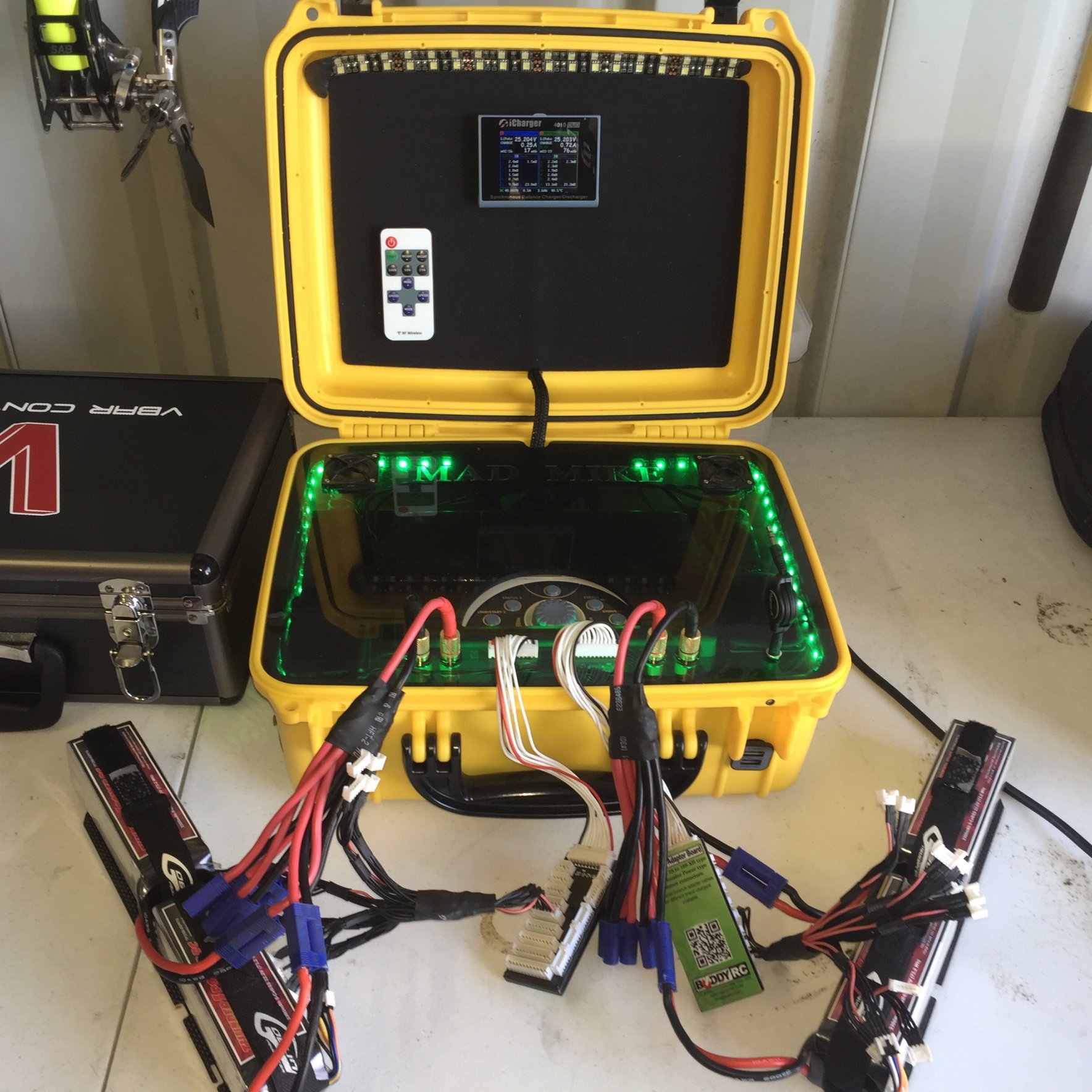

    15. hgnimda
      OKAY from the heligods funfly NOV 2015. Mad Mike decided to showcase his charger and @Crash Heligod caught a glimpse of it. See what happens next...
    16. Mad4Heli
      Mad4Heli Mad4Heli
      May 26, 2015
      36
      62
      image.jpg With I pod stereo, sub, night lights and tripod mounted.
      Some would say a little excessive
    17. ChopsyWA
      More like impressive! Nice charger setup!
    18. smakmeharder
      Nothing Exceeds Like Excess! I loved it. Work of art!
