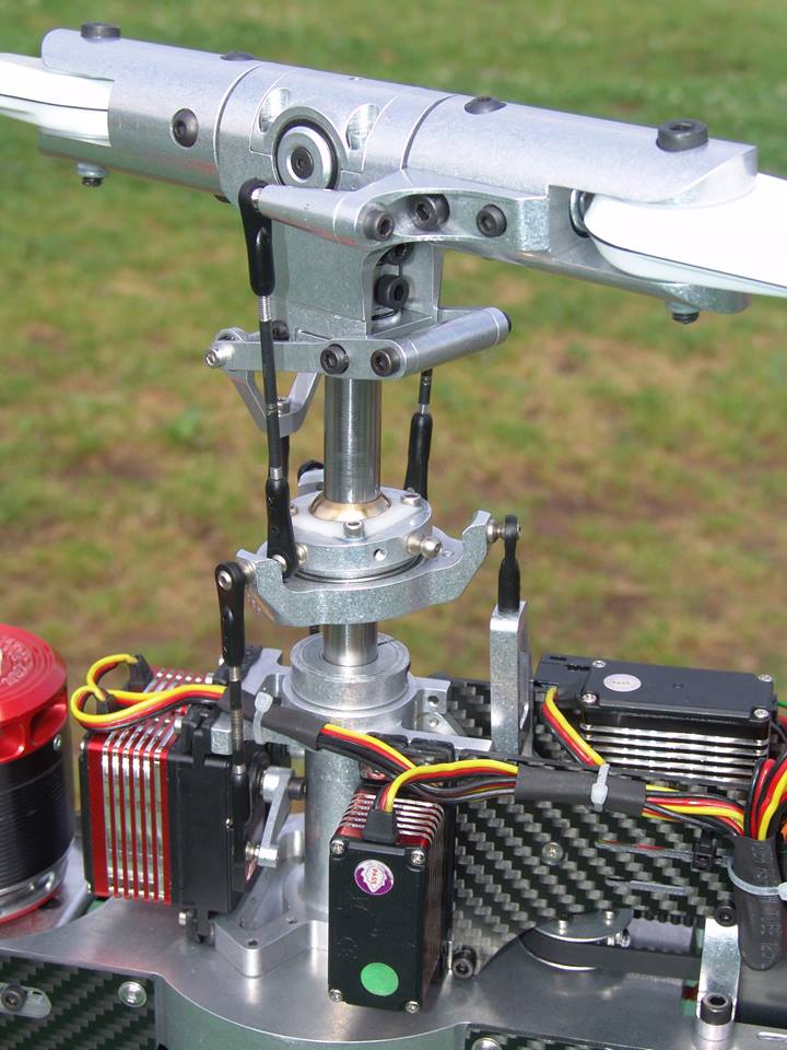

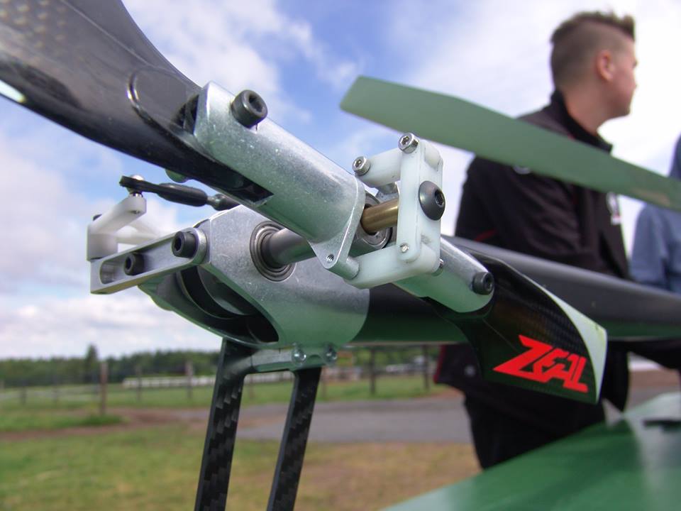

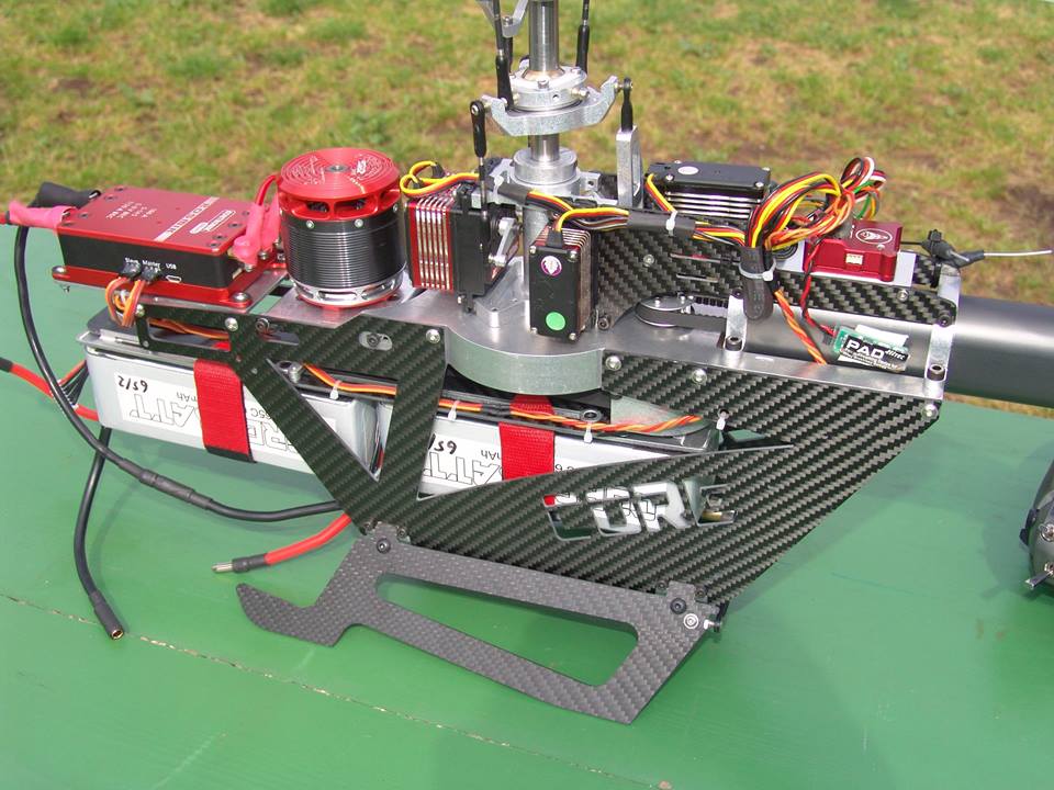

    A new RC Helicopter has hit the scene. Keep you eye out at IRCHA for the CORE 700. Note that most of the videos are in German Dialect. Check out the flight video, it is insane. The drive train looks to be unique with the drive pulley behind the main rotor shaft. The battery clip is uniqe as well. Servos are easy to access and the build appears to be average in comp[lexity. As an added feature it has RETRACTABLE LANDING GEAR. It looks to be a veryu capable helicopter.

      Looks like a BEAST... check out the flying video...Also look at how the tail section works. I have not seen this design before.

      I have seen that tail before on a trex 500. Someone in the US makes them as an upgrade.

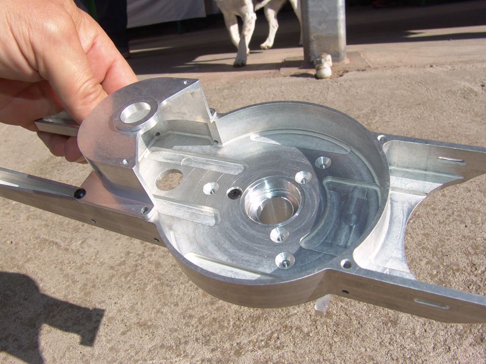

      That alloy frame looks weighty

      It looks heavy but its under 5 kg startweight. He sais the rotor has a different damping system.
      The dampeners are on the mainshaft not in the head itself. Therefore the blade holders can be easyer moved from the servos on heavy loads.
      Far more the whole construction holds 10 kv continuous power @2400 rpm. Thats much. I like the tail, the covered maingear and the retractable skids where you need a sequenzer on your tx.

      It looks small. But the heli can definitely move looking at the videos @Beaver. And the aluminum support is hollowed out mostly. Im not big on the retractable landing gear as the extra weight the servos will add. The battery tray looks to be a bit different and keeps the COG higher to wards the center. The head block looks to have the dampening provided by the center head bolt with the rubber oring? Again a bit different.

      There were complains regarding noise with straight main gear so Karcher switched to slant main gear.

      Looks like a well engineered machine, and the main shaft dampened head is definitely a different approach. It seems like a good idea, and I am interested to see how that is going to work out. Another thing I noticed, is how the main frames are designed like the Avant Mostro, and can be removed/changed without disturbing any of the electronic components. Personally, I can do without the retractable skids, although I can see the reason for them on a speed machine. All in all, it seems like a very interesting helicopter, and I can`t wait to see more from it.
