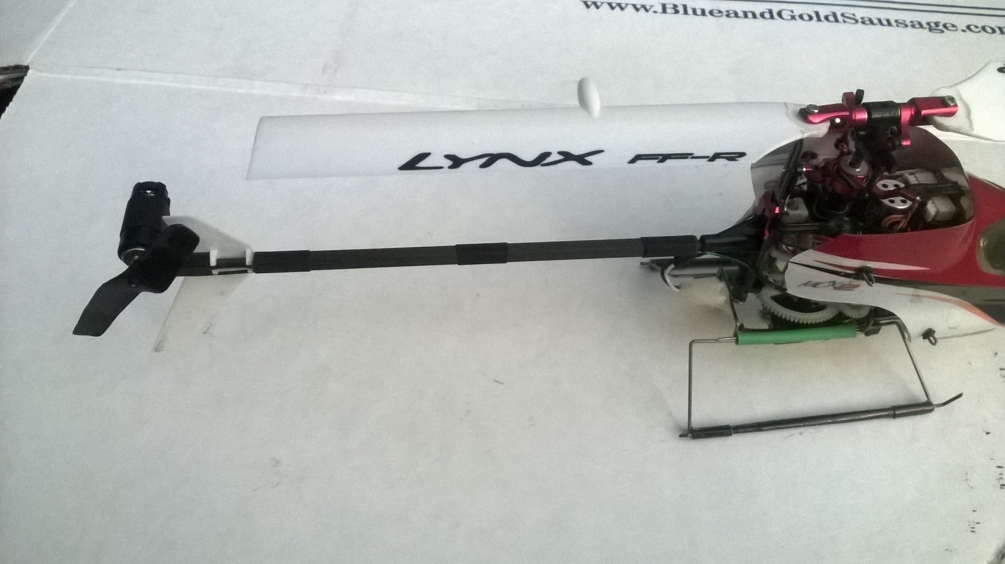

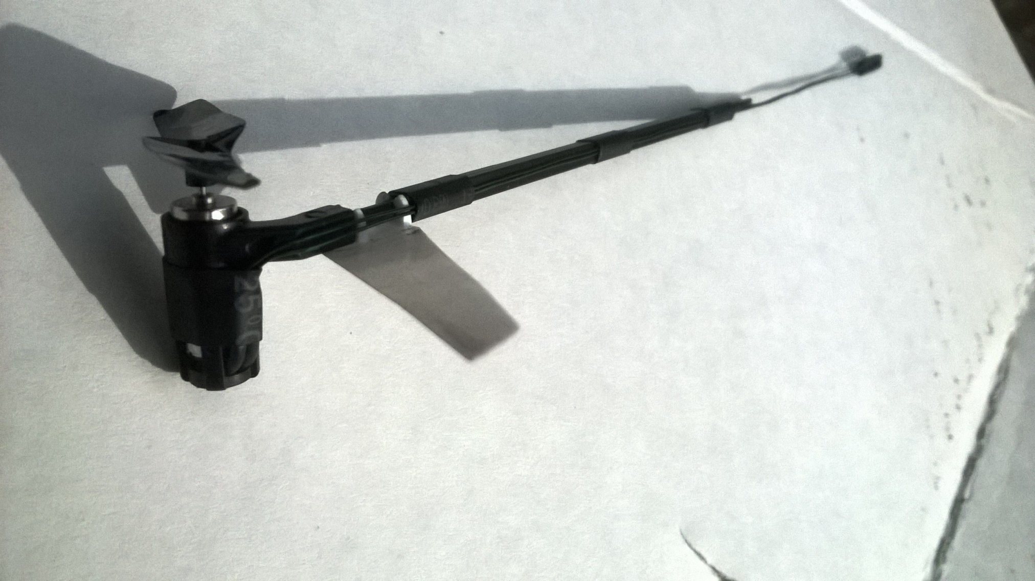

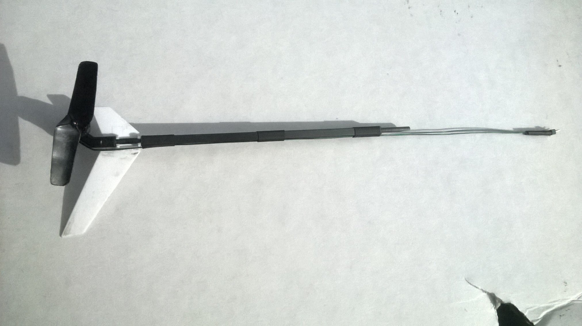

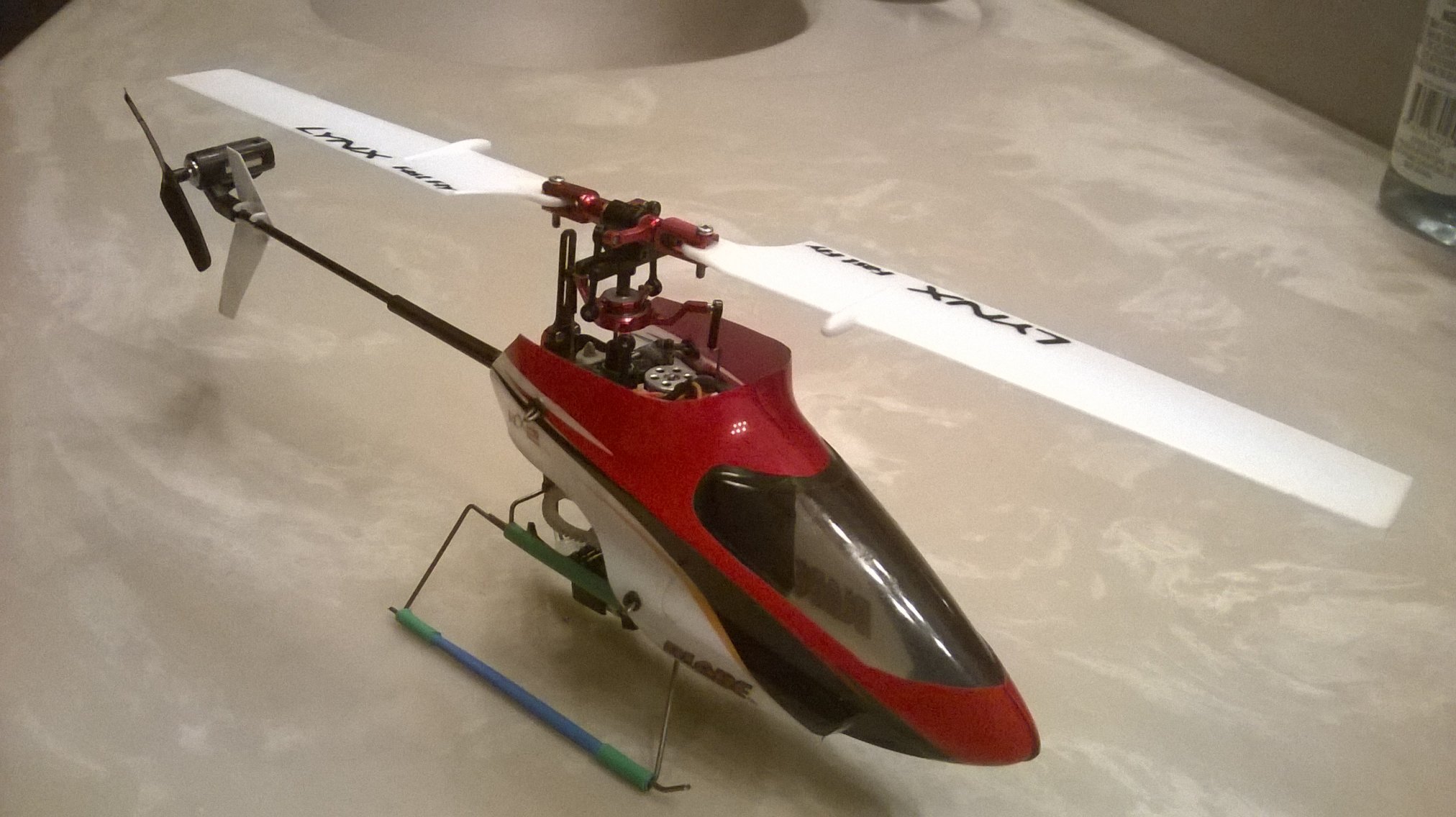

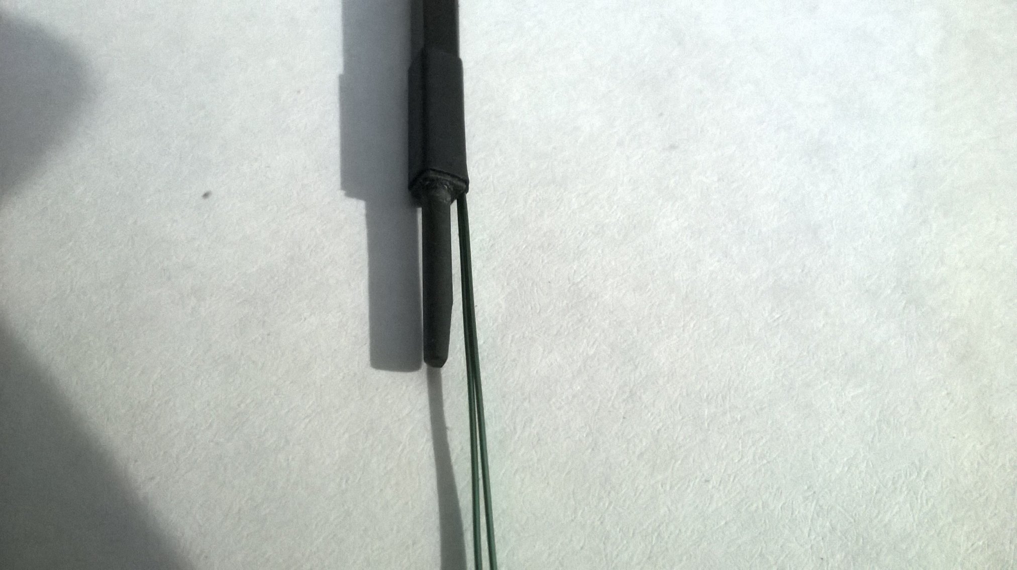

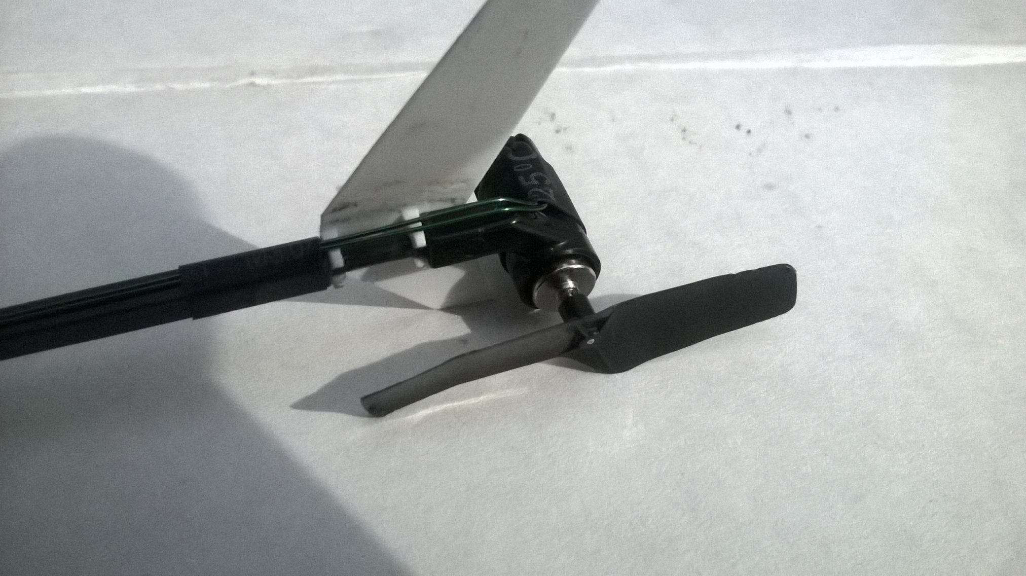

      WP_20150618_006.jpg WP_20150618_005.jpg WP_20150618_004.jpg WP_20150618_003.jpg WP_20150618_002.jpg This was a productive day. One 2mm solid CF canopy rod from a 120sr, one square CF tail boom from a 130x, some solid copper wire (Slightly larger guage than stock), heat-shrink tubing... presto! Composite tail boom for 100mm stretched Nano CPx. (originally only 85mm) Yet another step forward in mechanically taming the otherwise twitchy little bird. Aluminum swash plate, grips, and the BL kit helped as well. I ran 4 packs on the bird on this nice calm evening, and I like the results. It's very stable, feels like a larger heli, still has good collective authority but just a touch less pop. Power is good until I get crazy with the cyclic. A series of steep dives and hard climb-outs and I could hear the main rotor bogging a bit. Tail will drift a bit under hard rotor-loading, but only when packs get low. That's okay since I didn't intend this set-up for aggressive maneuvers. I'm still working rudimentary skills at this point. Nevertheless, The bird now flies comfortably and I don't have to worry about killing brushed motors or breaking tail booms or popping hubs out of swash plates or any of that nonsense..... just the damn "stop and drop" when the packs start to get low. I received E-mail confirmation from HH that my new Rx board arrived back there today for evaluation and/or service.
