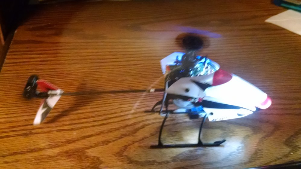

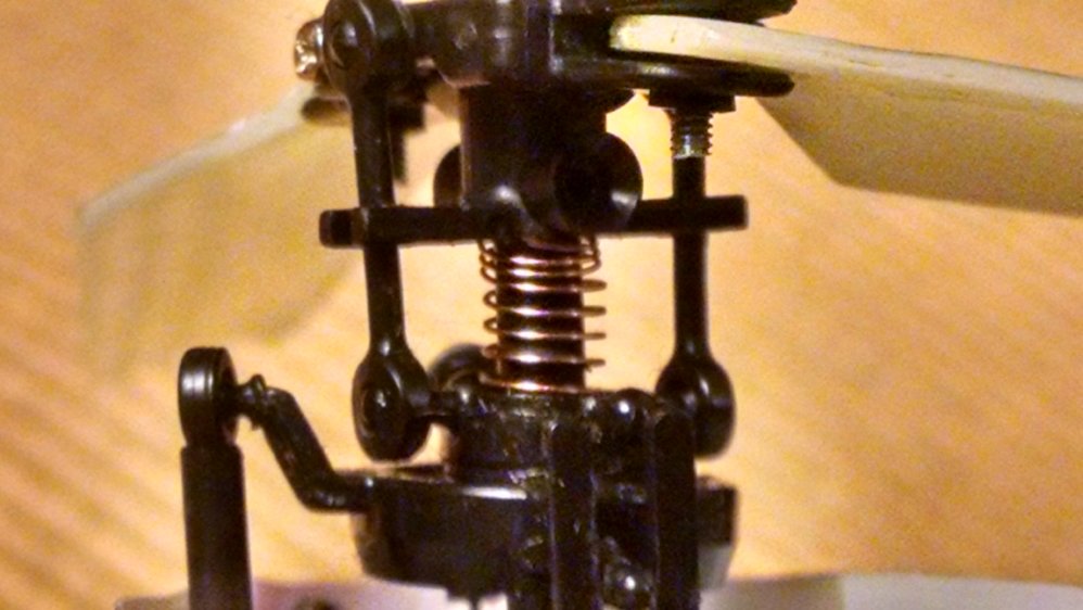

      The little mSRx is working out well. It's remarkably easy to get 45° nose-in funnels going. I had to put my trademark LED mod on it. IMG_20160610_223924233.jpg .... then of course there is the spring loaded swash mod that I first used on the old Nano CPx. IMG_20160610_224816285_HDR.jpg Cyclic response is nice and tight now.

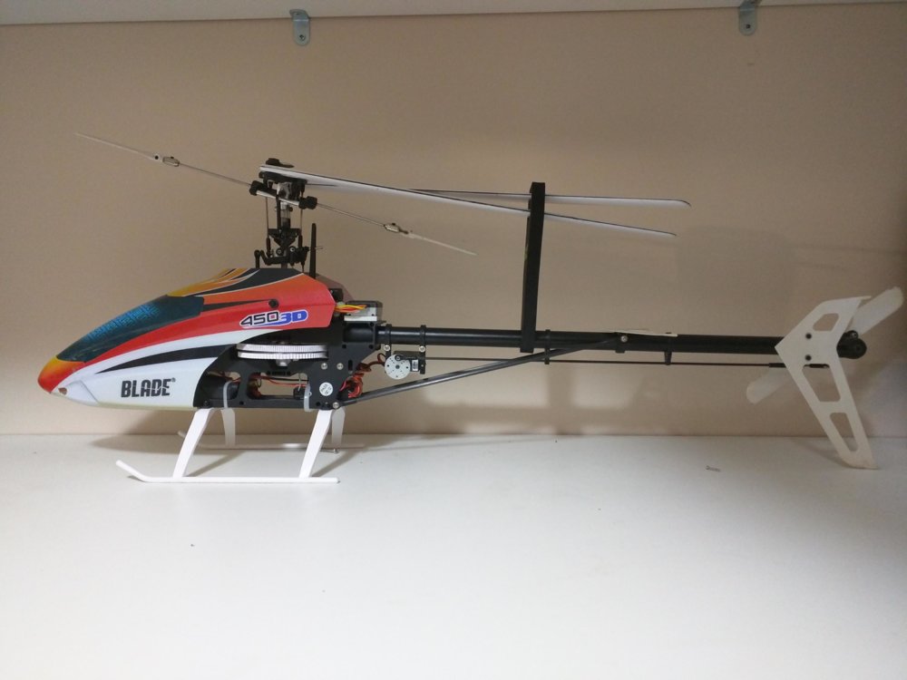

      I seem to have contradicted my previous statement of getting away from these Blade helis, and if this mSRx wasn't proof enough, I just pulled the trigger on a used Blade 450-3D BNF with a small parts lot and carbon main blades (not wood) for $110 (US) IMG_20160518_075212.jpg ..... flight ready other than needing s Dean's connector. It has one miniscule hole in the eggshell.. uh, canopy that is. I might have to make some minor setup changes to get the old fly-barred bird to work with my DX4e, or try the HP6DSM "SR" radio. Nothing wrong with my CX450, I just felt the need to have a spare 450 in case one is grounded.

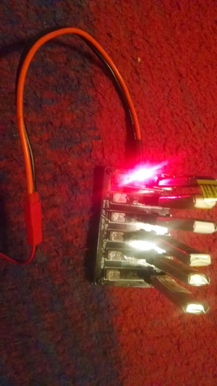

      An interesting thing happened today. I went to the LHS today, scouting and memorizing their inventory of B450 and mSRx parts, and ended up buying a Venom 12 port 1S charge board so I can parallel charge my mSRx cells. I made it home and installed a JST connector on the leads, observing correct polarity as usual, but oddly enough, at first test the charger wasnt recognizing the new board to initiate charge cycle. I stopped for a few minutes to contemplate the problem. Then I started smelling burning semiconductors and disconnected things. Batteries were warm, charger was hot, but not burnt.
      Further inspection revealed that the main leads inside the new board were installed in REVERSE polarity!
      I fired up the soldering iron again and the problem was corrected easy enough. I'll be calling the LHS tomorrow to advise them of the problem. If it had been someone else, a LiPo fire could have resulted. IMG_20160614_234559315.jpg

      Holy MOLEY! That could case a serious fire if left unattended! Good find @Beaver that really deserves a product recall IMO. The distributor should take serious action on this issue.

      The LHS said they haven't had any problems, maybe I should contact Venom directly.

      Initial inspection revealed a few small problems with the B450:
      One cyclic servo felt like gears were iffy as well as possibly tail servo.... purchased one cyclic servo with two sets of gears and one set of tail servo gears. The servos themselves are digital and coreless with speed rated at 0.04, which is faster than I expected them to be. Plastic gears didnt make much sense to me. Does the flybar mixing to the head dampen torque feedback to the servos?? No big deal..... the gear sets are cheap enough.
      I didn't like how the ESC was mounted, so I pulled it and reversed it so the main leads are under the battery mount instead of out the side of the frame.
      I'm not entirely sure how the radio situation will work out yet. I might try the old SR radio since it is designed to work with that type of Rx configuration. If all else fails, I'll get another K-Bar and sat-Rx for it. I can always put a CopterX 450 Pro head on it for cheap.
      Other than the cracked canopy, everything else seems in order. Included spare parts included several main and tail drive gears, main shafts, and feathering spindles. I already have a set of paddles and weights. It's too g to be a late night for sure going through and setting up this bird. :D

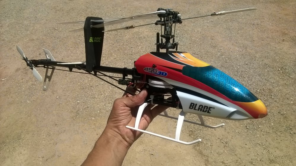

      Suffice to say... setting up a fly bar heli is a trip. I had to flip the grips and swap some servo leads to get proper swash response to Tx.
      Test flight today..... this should be fun. :D
    13. Beaver
      Omg..... that was weird!
      Bad tail wag on first lift off....
      Too much tail gain..... and threw a tail blade first attempt from barely touching ground tail first. Put smaller blades on and reset servo position.... no wag there, but noticed a crack in the plastic tail housing..... I see a metal tail casing in the immediate future.
      I tried a piro and almost lost it... rate too slow. I very nearly put the thing in, but managed to recover thanks to plentiful cyclic rate.
      Cyclic response is good, but not much collective throw there.... It gets off the ground, but there's no pop to it at all.... probably the radio (Blade SR/HP6DSM).
      I'm seriously considering pulling FBL head and K-Bar from CX450SE and slapping them on the B450! (Looks like an easy mod)

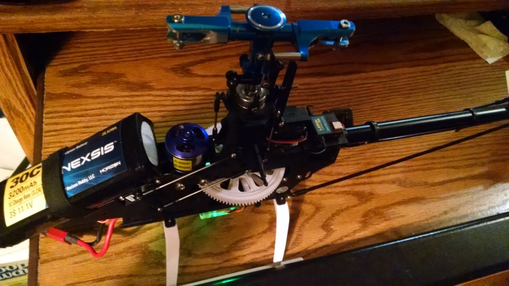

      The Blade 450-3D is now flybarless!
      Will install blades and test tomorrow. :cool: IMG_20160618_021816888.jpg
      WHOA... NICE @Beaver! You are going to enjoy this lil bird. Now as for the gyro, whats on the heli at themoment? A kbar would be a good choice because the vbar is a good gyro - make sure you get the cyclic throw and pitch right... around 12deg collective and probably 7-11 cyclic - depending on your flying. Great to see.
    16. Beaver
      That little yellow glow underneath the heli is the Kbar. I borrowed Kbar and head from the CX450 since its waiting on parts (China Post).
