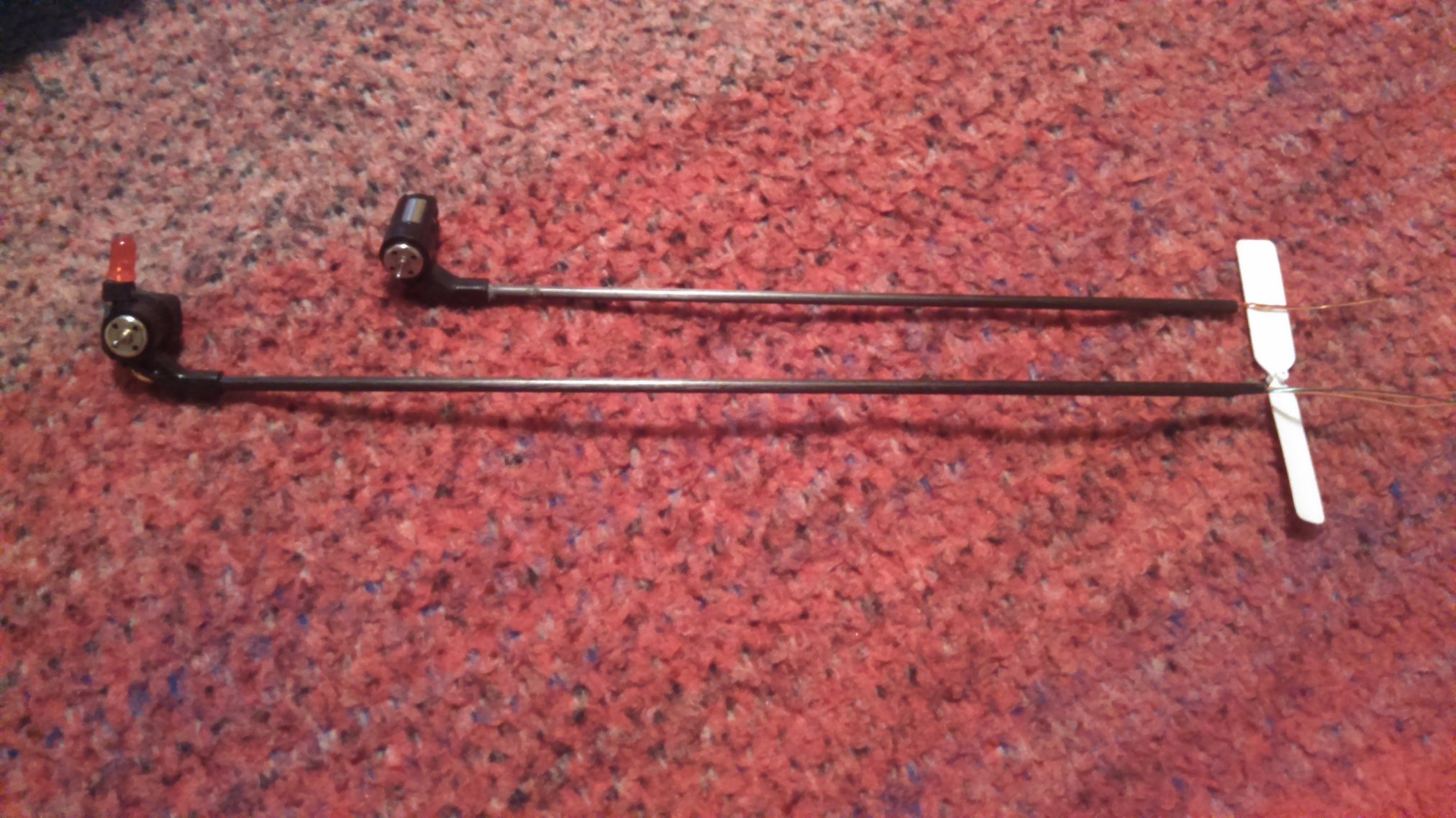

      Stretch boom wired and ready with LED and new tail motor. IMG_20160522_235653_791.jpg ..... Turns out, old boom has a split in it and needed to be replaced anyway. :D
      just watch the extra weight on the tail @Beaver... might hurt the cog. But if its the 120 sr should not be too much of a problem. Will look good as a night flier!
      I've had the stretch tail on before. I went back stock for awhile.
