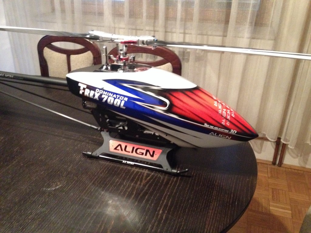

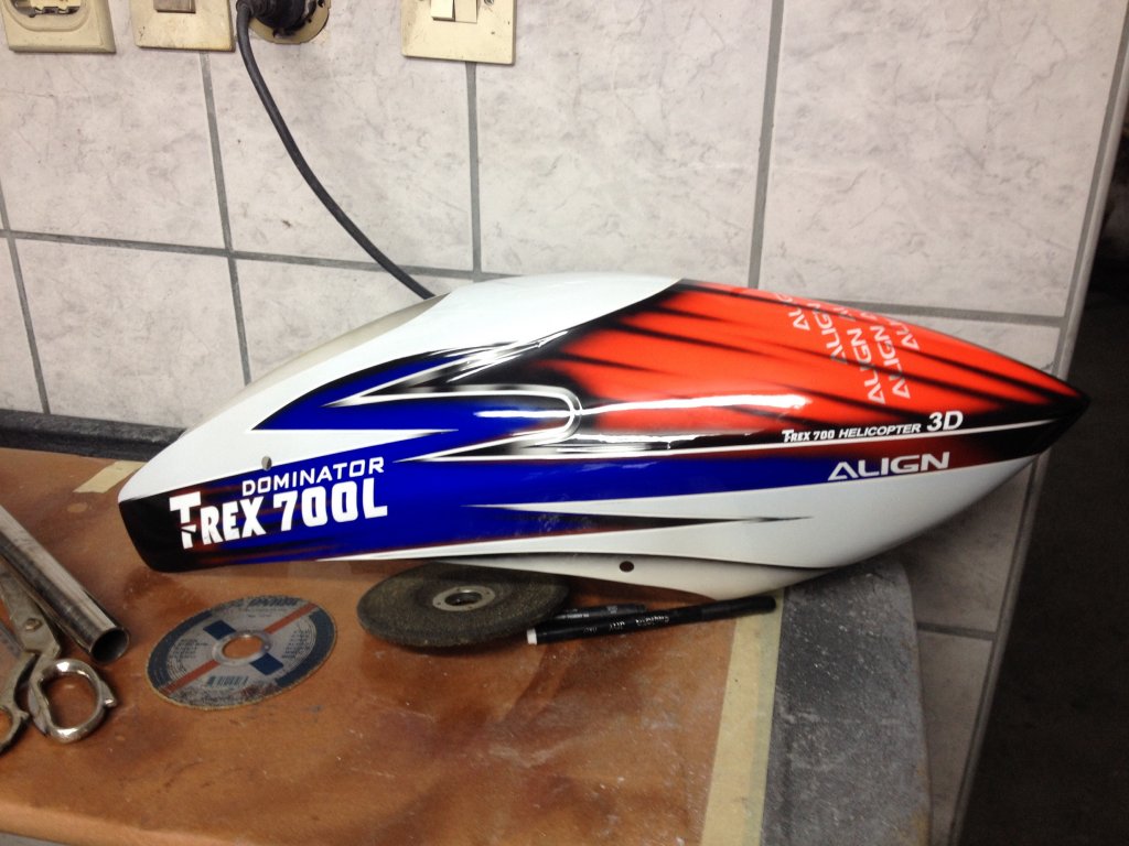

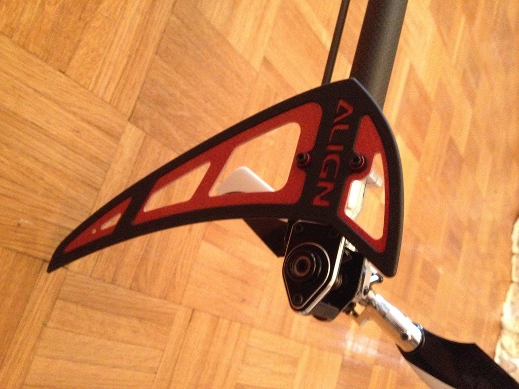

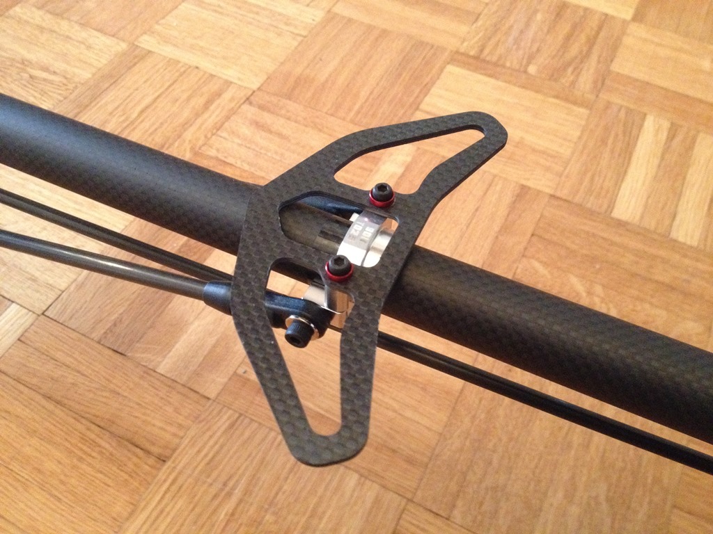

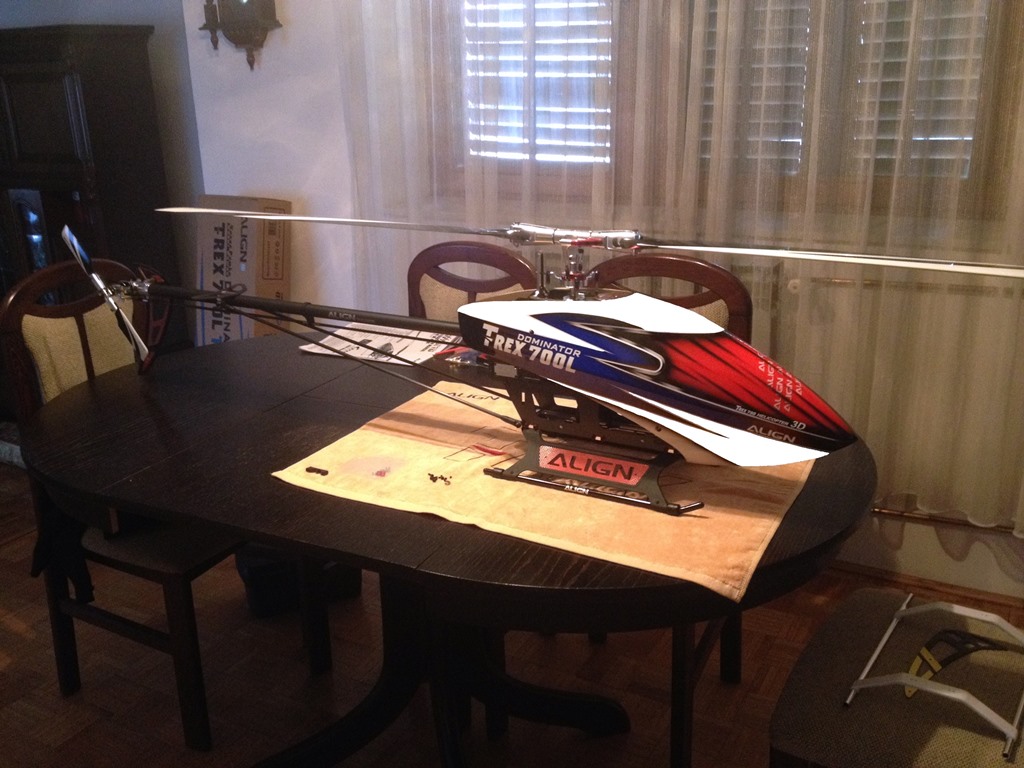

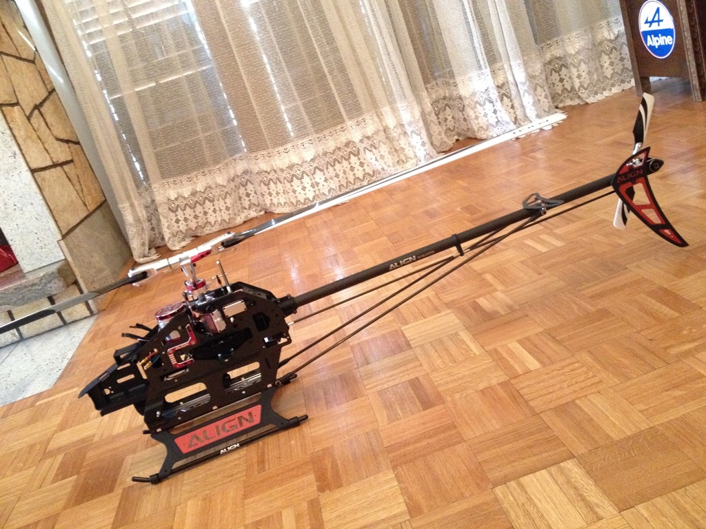

      The custom job on my Top is almost done. Alu washers and 800 landing gear and fin arrived today. The painture of the canopy.. Here is a Photoshop pic as well. Doesnt it look sweet?? :)

    8. iggy

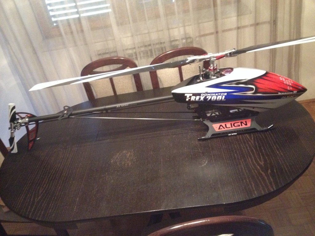

      image.jpg image.jpg image.jpg The custom job is done. Have a look guys... An Align can look so amazing if you do something on your own. I will maiden it next year. Its winter in Europe..

      What an extrodinary 700 you have their @iggy! Love the landing skids and you are powering it using an 850Mx? Seriously thats awesome power. Some people i know run the 800s and they really hammer. What size speedy are you going to use? I would think a 160 at least... Love the align alloy base tray and the bits of red bling at various spots. Absolutely magnificent!

      Thank you very much! Im in love with this bird now. The look is just how it should be out of Aligns factory. The red alu washers are very shiny on the matte black carbon. Very nice detail. My buddy did an awesome job with the canopy painting. Its perfect.
