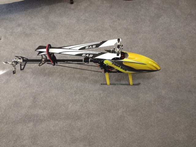

      I have a 700MX 510 I might want to try in my 600, mine is the old school 600, pre ESP, that I converted to 12S years ago. I used the 630KV Scorpion, but that motor is old now, it is the pre HKIII, so I have most of the kit that is the power boost kit, main gear, pinion, motor, KDE motor mount, and adjustable boom block kit.

      Quite pleased with the 700MX 510 nice smooth power, not monster power, just clean steady hum coming from my beasty now!
