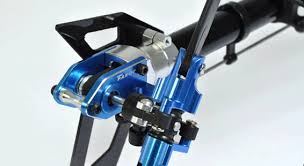

    I have seen a few different tail setups in the past. So i am wondering what is the absolute best performing tail system out there.
    The new Align tail system looks good.
    There there is the Heneselit tail system
    Vortex Tail System
    Alees Rush 750
    So are there any other unique designs you can think of and which system is the superior one?

      A good Tail system should have counterweighted grips - so easy to do.. .not sure why hardly anyone is doing it..
      Align started doing it for a while on the 450s but seem to have fallen off doing them too?
      The counterweights dramatically lower the load on the tail servo... so unless there is an adverse effect I'm unaware of, why aren't they all using them ?

      Have been reading about rc-tek tail grips which are available for most size helis and their ability allow the servo to work more efficiently and to improve tail holding power by evening out the forces
      Thinking about getting a set of the below to improve my tail performance. Lot of people who have used them on Trex have claimed big tail performance improvements.
      http://www.rc-tek.com/store/i2rc-hi...-blade-tail-grip-assembly-with-hub-p2320.html
      The logic being their design and ability to improve tail holding / performance is that a normal grip will naturally want to spin with zero pitch on the blades. To twist the blades away from zero pitch requires an increasing amount of force. The chinese weights change the moment of inertia, so that the force required to rotate the blades changes much less over their range of travel. Therefore, your tail servo doesn't have to work so hard, and can respond faster to required pitch changes.
      Here are some videos showing the improvement that a chinese weights approach design provides.
      Thoughts?

      @gonehelimad Chinese weights are standard on tge avant mostro .. must be one of the tuffest yet still smooth tails ive owned (srimrok faifa still holds the mantle )
