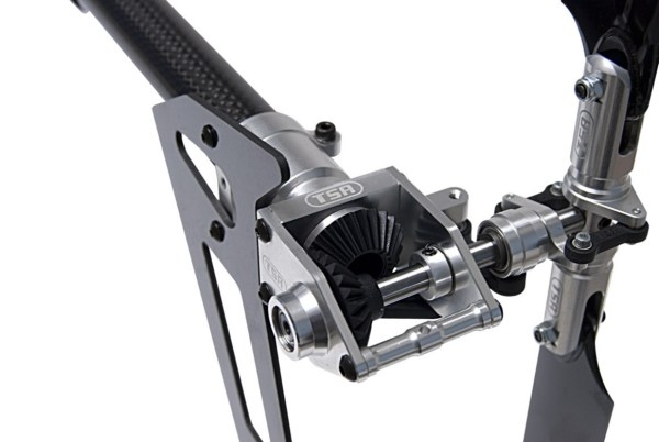

      The tail box on TSA Platinum helicopters is pretty impressive. It`s very beefy yet light weight and the gears are very tough. I have yet to replace a set of tail gears after a crash. The tail gears are pinned to the output shaft, so in the event that a gear is stripped...you can change it without having to replace the whole shaft. Another big plus is the same tail box is used on the 600s and 700s.

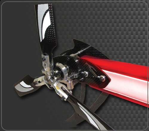

      Exhibit A, The SAB Urukay three bladed tail.

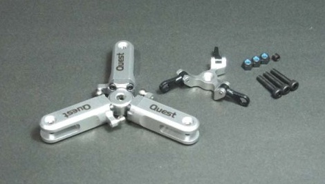

      Exhibit B, Quest helicopters also do the same

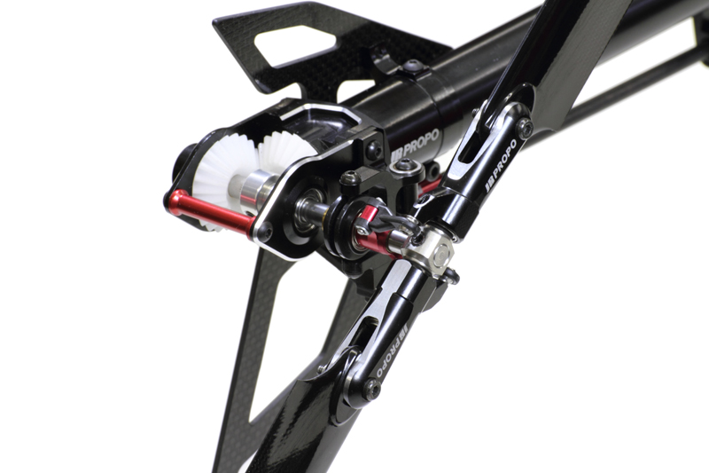

      Exhibit C, JR Helicopters tail

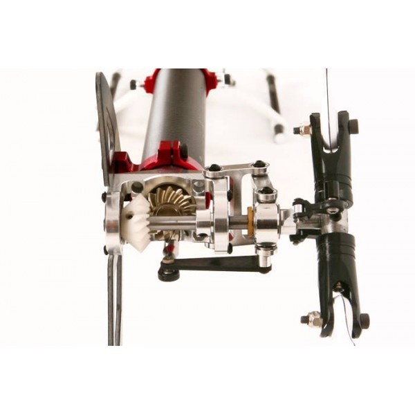

      Exhibit D, The Hirobo Turbulence D3 V2 tail
      Some of the mentioned manufacturers have won F3C contests.

      If it comes to innovation, I would give credit to SAB and quest for bringing out 3 bladed tails.
