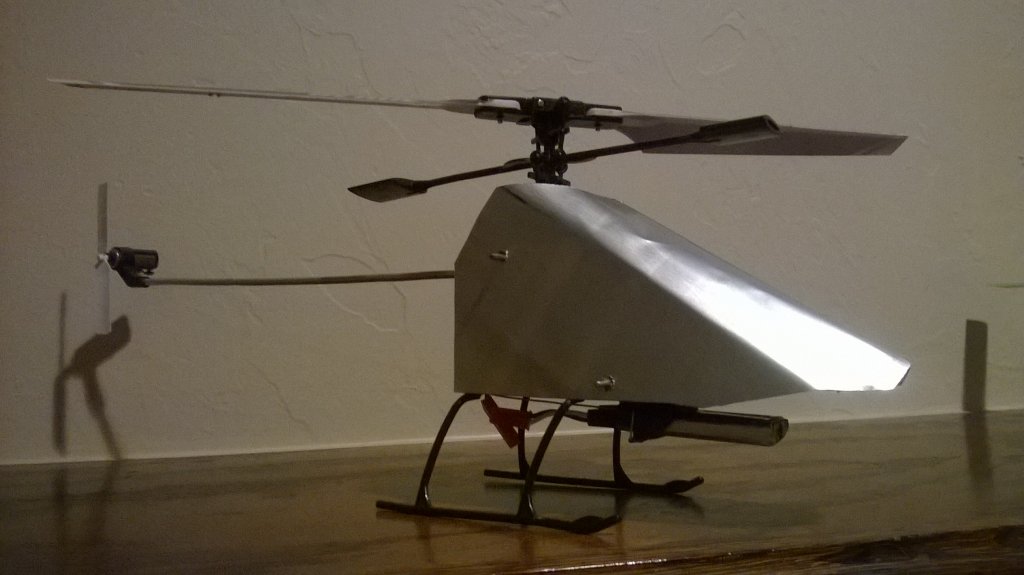

      WP_20150216_003.jpg :DNevermind the plastic bottle, too noisy- acts like a resonance chamber for motor and gear noise. Went with aluminum can and a couple of strips of gorilla tape inside to deaden the noise...... much quieter. Save a whale, hug a tree.... recycle! (I'm really not that "green")

      The human spirit of endevour! Go forth and continue @Beaver! You could actually form a tin can as well i imagine (cut the alunimum and form it on some sort of home made dye?).

      (pic finally uploaded) ... I was thinking metal primer and then fluorescent green paint for better visibility. It's a Monster Energy can and I was going to use the painted side with the "M" logo, but decided on reversing it since black is hard to see.

      Oh wow! looks like a starwars type droid! It also has stealth capabilities with the sharp angles and stuff. Not too bad at all. Very clever @Beaver.

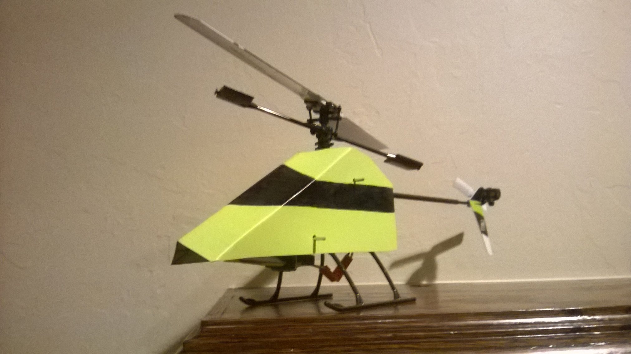

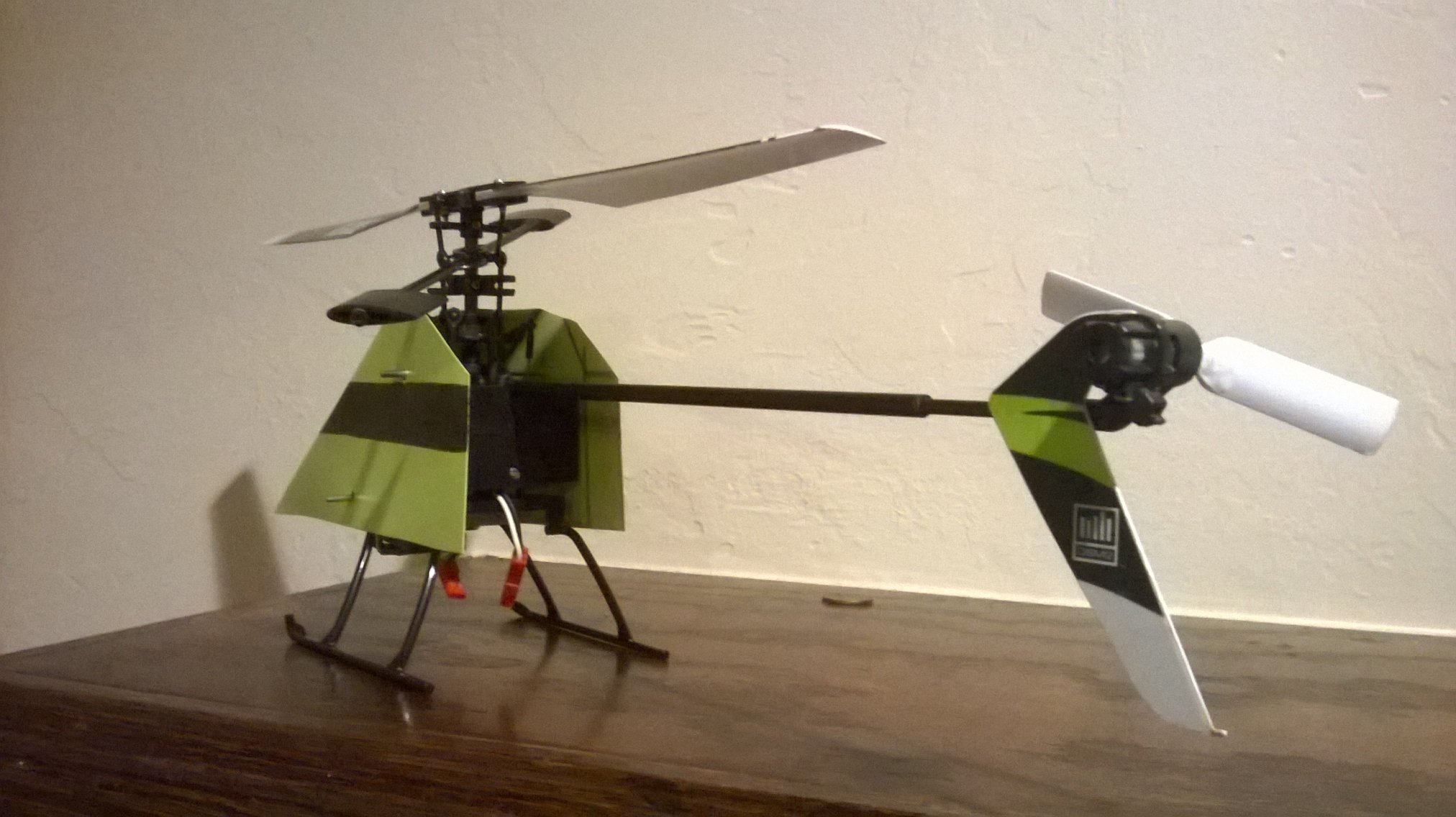

      Since there's no activity on this thread anyway............. "Cut and fold" canopy Version 2 made from Lexan semi-rigid clear plastic sheet, primed and painted. Aluminum worked great, but too susceptible to dents and dings. Lexan prototype 1.jpg Lexan prototype 2.jpg Tail boom extended 30mm to get tail rotor out from under main rotor for improved response. Will be adding 185mm (200srx)blades next.

      Yes.... very very very cool... and looking more like an xwing.. How does it look in the air? The old 120SR is a great helicopter, i cut my teeth on this heli years ago and wish i had a neverending supply of canopies like this one. You are very resourceful beaver...
    14. Beaver
      Flies good enough, doesn't look bad. Definitely no tail blow-out with 30mm extension, especially with 600mAh 35c lipo. I'll have to shoot some video of it.
