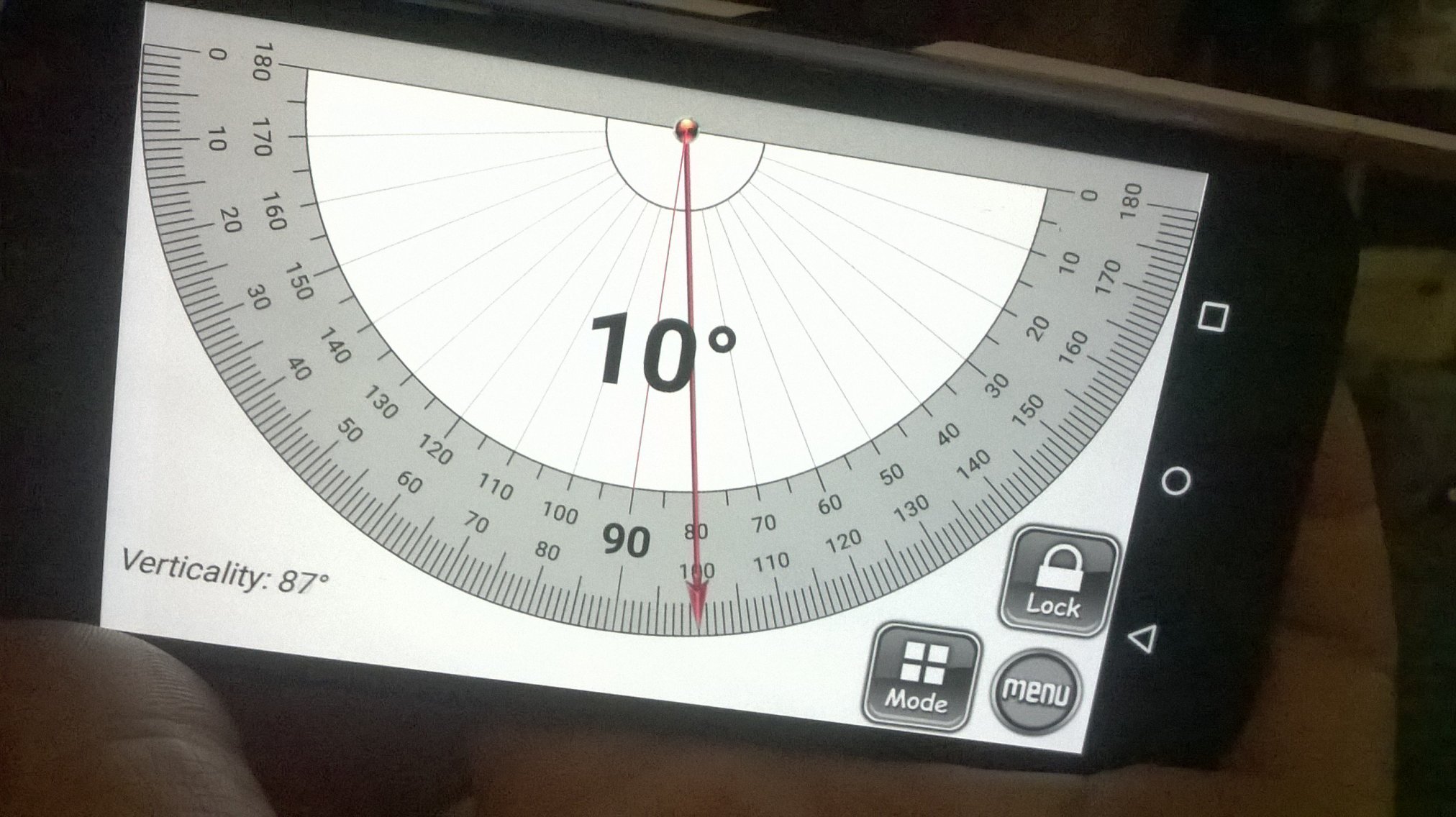

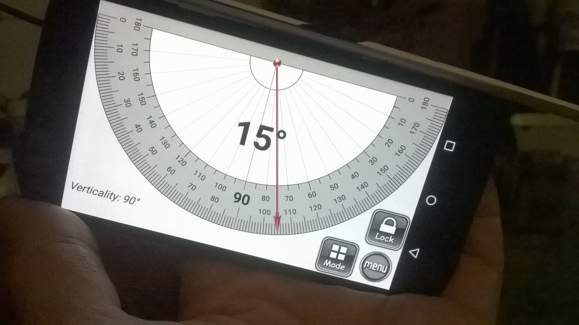

      It was a rather fast twitch..... say, 4 or 5 twitches per second, back and forth about 2cm both ways. Not bad, but just enough to be visually annoying. That's why I thought the gain might be just a touch too high. I had the collective stroke set way too long.... full pitch was about 15°..... a wee bit too steep. I have it at about 10° now.
      Ok ...in that case turn it down for sure. Also double check the frequency of your tail servo - make sure its correct in the gyro. Also make sure that the tail is dead centre when first initializing.

      The tail had been staying locked in up until I pegged the collective full on that one time with way too much pitch. I'm pretty sure that was most of the problem. Tail blades are stock that came with the kit. Servo setup is correct.
      Ok... 12 degrees max at this stage I would think...

      I found a handy little app called ON Protractor that uses screen tilt to measure angles. I went back and double checked the pitch settings from before and after. I was guessing before, but still right on by the measurements, using blades turned 90 degrees on grips for a base line with servos active. Ready for next flight!
      I also adjusted the settings in the sim to more closely match my 450, now that I have a better idea how it reacts in reality.:D
