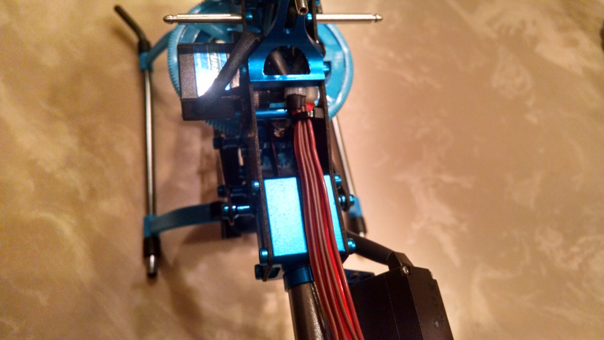

      Where appearances go, I'm still working g on that as well. Tonight I routed the servo wiring. What I could not hide inside the frame, I sheathed in heat shrink tubing (not heated) as well as the ones inside the frame where they run past the mainshaft. I have yet to shorten them. IMG_20151221_011244144.jpg IMG_20151221_011012613_HDR.jpg

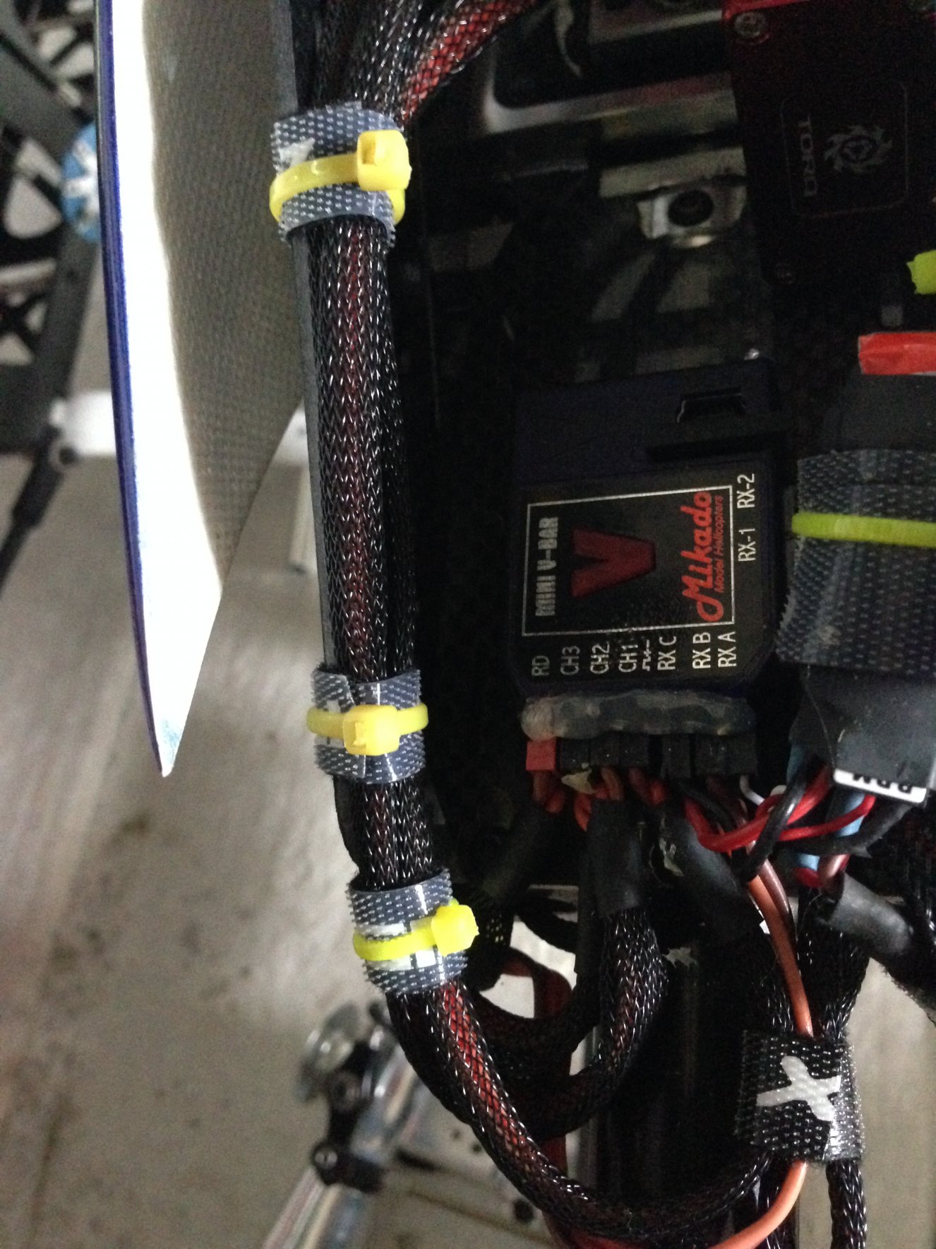

      It's a good idea to protect your wires with some double sided velcro like the image (buy align strips), it stops the cable tie wearing through the wires under vibration (keeps @Crash Heligod at bay)
      See image - no need to worry about the cable sheath, that's for aesthetics. And hot glue the servo pugs into the FBL as well

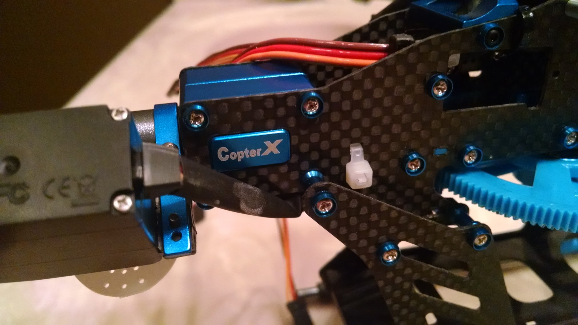

      Ugh! That main gear..... out of concentric just enough to be annoying when setting the pinion to the maingear.
      Anyway, motor set, ESC installed finally. Now to tame those servo leads. :cool: IMG_20151223_244829903_HDR.jpg

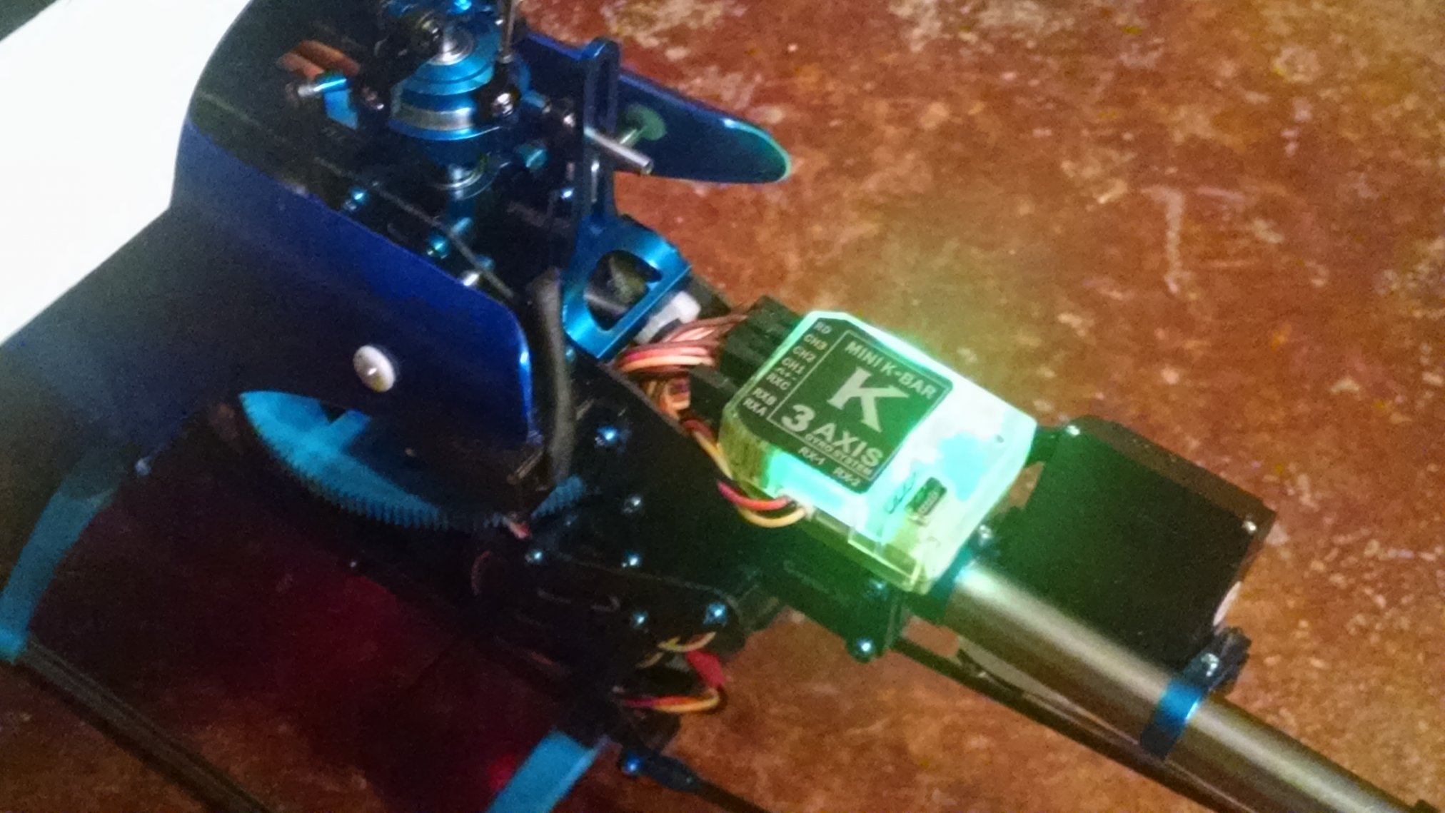

      Ground test, no main blades:
      Everything seems to work as expected. I don't like the vibration in the tail rotor. I'll be looking into that next. Blades could be out of balance, I'll spool it up again shortly without tail blades and see if anything changes. It's close to being ready. :D

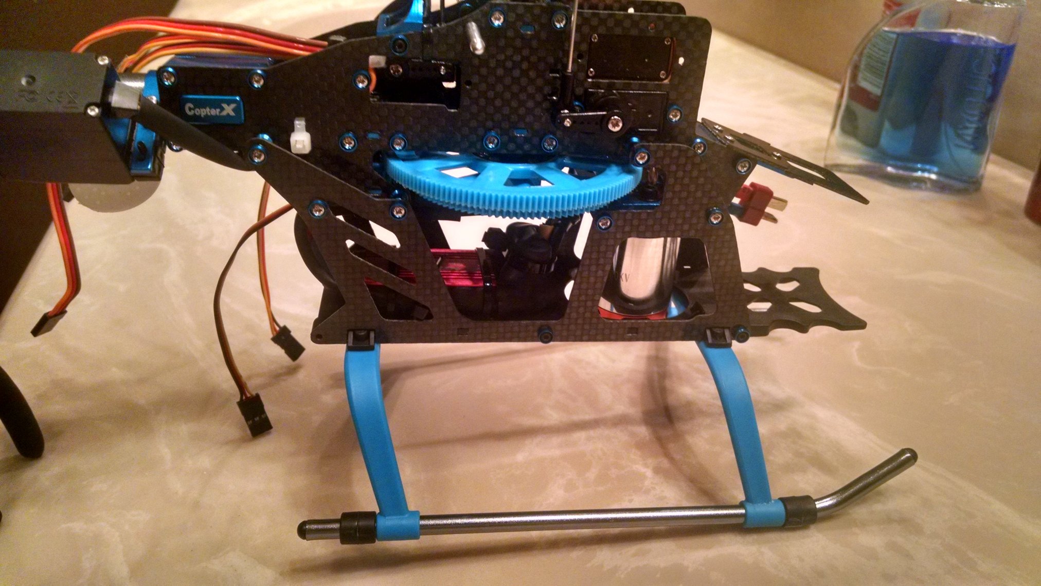

    19. Beaver
      So that tail problem may have been that the tail blades were binding on the grip screws. Installation of the last few items such as boom supports and battery, all bearings properly lubed, the bird is now complete.
      One final run of the Kbar to finalize the setup by setting the gains, increasing the swash agility a bit closer to what I was accustomed to with the Nano CPx, and duplicate copying all the memory banks the same.... for now.
      Weather permitting, maiden flight will be tomorrow.
      Weather not permitting, it might only be a few minutes of hovering in the shop. Either way, the bird will fly tomorrow.
      Merry Christmas, Seasons Greetings, Happy Heli-days to you all. :D:D:D IMG_20151223_233328959.jpg IMG_20151223_233500857.jpg
