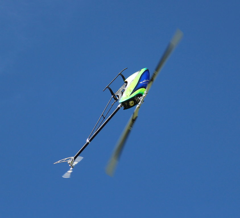

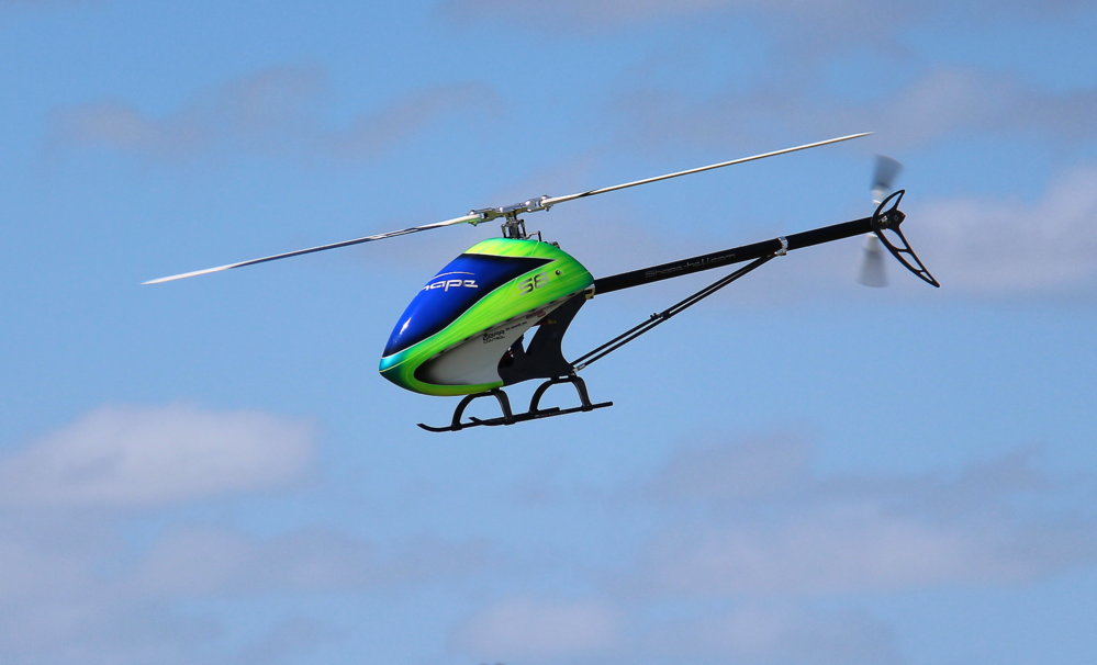

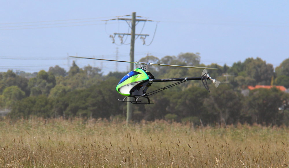

      Maiden flight was a success.... Needed some head gain and some adjustment of the Gov to get the head speeds I want which ended up being 1350, 1650 and 1850
      I was surprised how light it felt, it weighs 6.8kg with 2 6s 5000 packs.... 12s on this machine works! A lot faster than I thought it would as well oh and quite Agile too....
      Got a quick vid done as well..... the camera man lost sight and gave up, but what he got was good enough to give you an idea, shame about the pilot lol
