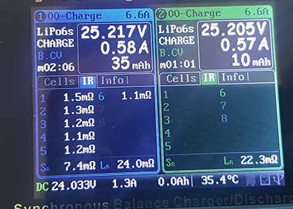

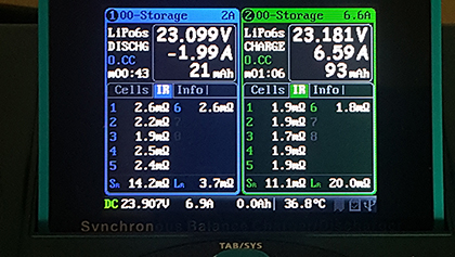

    Battery Internal Resistance
    Battery IR levels at completion of flight 8 (during storage charge are as per below). Generally across both batteries. IRs are consistently 1.7mOhms - 2.6mOhms (varies based on state of charge) but generally uniform across all cells
    Battery IR during charge (nearing charge completion) as per below - consistent for both batteries (pack 1)
    Battery Cells Balancing
    At this early stage, batteries are balancing perfectly at 4.2v per cell.
