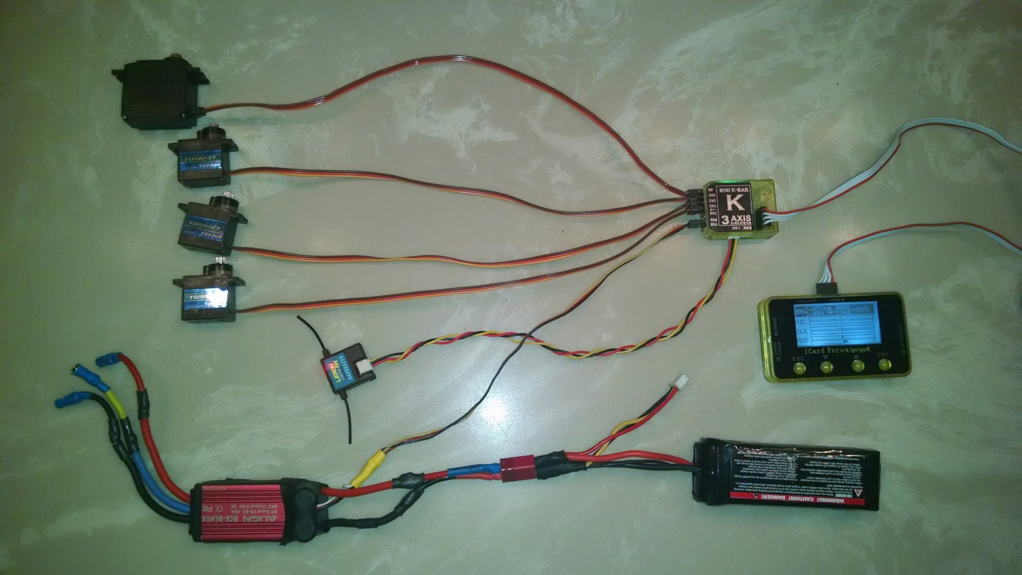

    13. Beaver
      Happy moment....... My first FBL! :D
      (I don't count the ASS3X in the Nano)
      Now to link up the USB and get familiar with the setup.

      .......So anyway, it was a bit of a trick getting g the Kbar to link up with the VStabi software on my laptop through the USB ports. Damn Windows 10 wouldn't accept the drivers right off till I copied the *.sys files out of their subdirectories and pasted them into the main folder with the *.inf file. In other words, I had to "trick" Win10 into accepting the drivers. Having done that, all is well.
      Everything seems pretty straight forward in the setup. I've already programmed Kbar to my radio and set what I could without a motor and airframe. It is nice to be able to check out how the different settings have different effects on servo and gyro response. Everything is in working order so far, I can't complain a bit....... except for the "driver problem". There was an hour of my life I won't get back. :D
