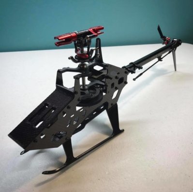

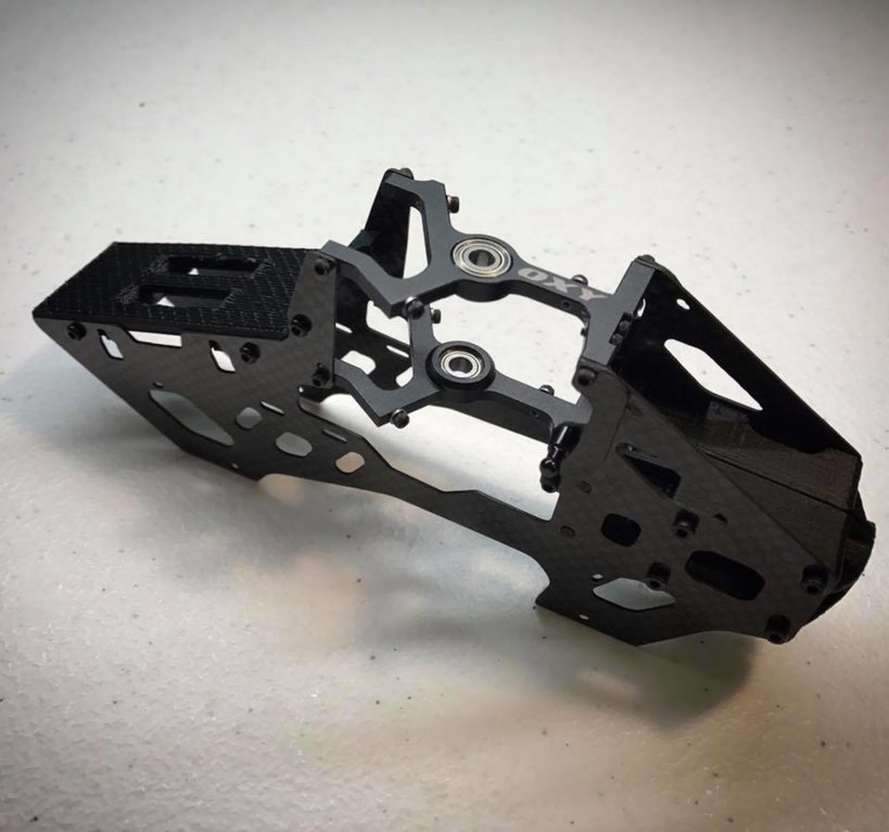

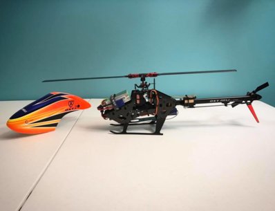

    OXY 2 just release the OXY 2 FE.
    They are taking Pre-Orders now. Just e-mail
    [email protected]
    The only 200 size kit on market as far as I know.
    Here is a size comparison.
    Maybe we can get a OXY 2 mini forum on here?

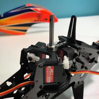

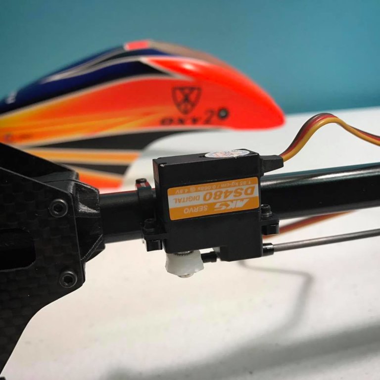

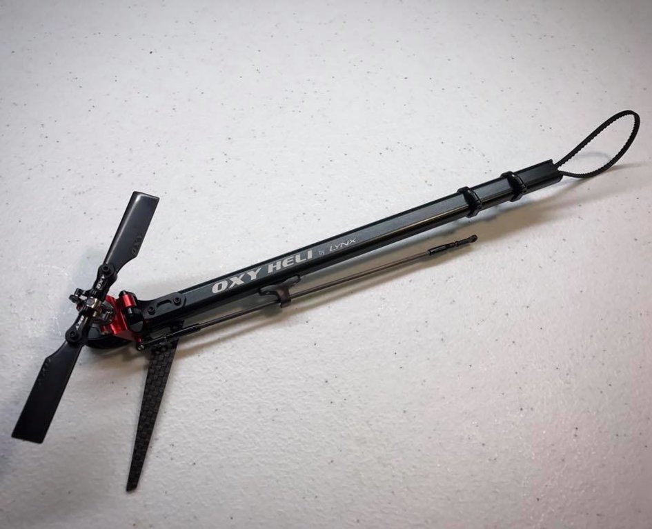

      Well I crashed my 2 in a test today.
      I did a test hover down stairs and got caught in wall wash. Crashed my OXY 2 into the cement wall. Hit TH in time.
      Damage:
      Elevator servo has a glitch now (gears are still good but it needs replacing )
      Servo saver arm (later found servo had same jump at full + pitch )
      Main shaft has a micro bend but enough to make a vib.
      Spindle
      Every thing else is good.
      Not bad for hitting a cement wall. They up held there OXY 3 low parts count in crash reputation.

      I got stuck in wash and caught a cement wall at a HS of 3800 and only micro bend in main shaft and bent spindle. I had to replace a servo is developed a twitch at max pitch.
      This is the shaft replacement from that crash.

      Servo saver worked , I think the servo was a week one.

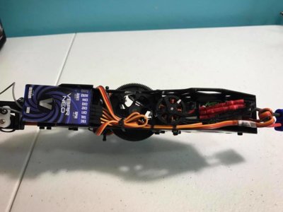

      Aron Prong:
      Oxy 2 Qube... the best micro size setup I've ever tried...
      Hobbywing 30A ESC
      Lynx Eox 1611 Motor (10t pinion)
      Lynx micro servos
      Spektrum tail servo
      ubrain2
      3800-4200-4600 Headspeed

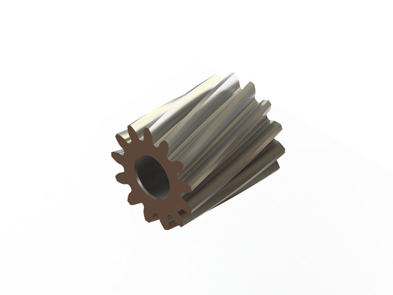

      Pinions for the new EOX 1911
      2.5 shaft.
      11t, 12T, 13T are now available.
