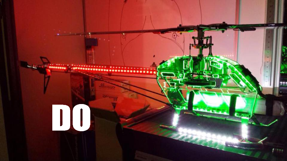

      Do's
      - Spend time considering colour choices and layout
      - Consider colour of your night blades and how that will contrast against the boom or canopy colours
      - Plan your project in stages (stick all the LED strips in one go, do all the soldering as a separate stage)
      - Use a separate dedicated battery (if you use your RX pack the LED strips will dim as your servos draw load from the RX battery)
      - Consider future servicing of the tail gears and things like that. Use connectors (EC2, JST, Servo Plug, etc) to allow you to easily remove the boom
      - Use night blades with replaceable batteries if possible (batteries dying INSIDE night blades will give you headaches)
      - Test the night rig during the day, fly it, with all the lights on. If the lights magically "turn off" during the night it can be a tedious situation to deal with
      Don'ts
      - Don't run 3s unless you're using something like a Dalcon. If you are having ALL LEDS on ALL THE TIME, 2s is a better choice and it won't overpower your night blades and look like a blurry orb of light when high up / at a distance
      - Don't try to make your own night tail blades
      - Don't fly in very unfamiliar places, last thing you wanna do is hit a goal post with your precious rig
      - Don't over complicate the setup, the KISS principal will give you the best results and most amount of enjoyment.
