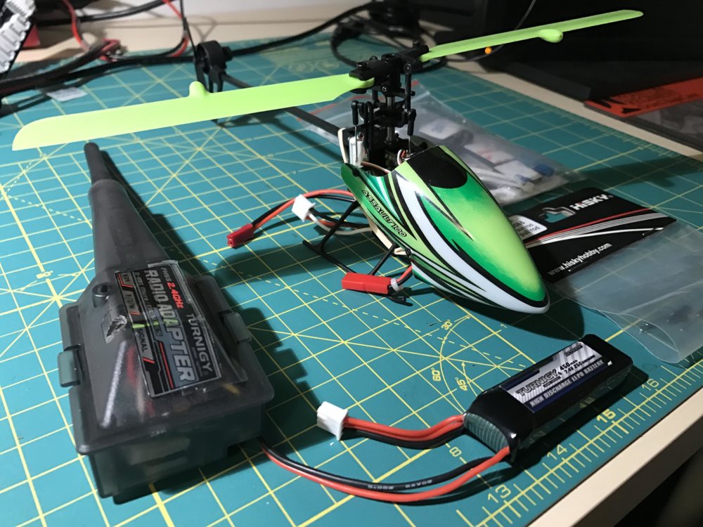

    Yes, I found a deal on an Assault 100-v2, with brushless main and tail motors. It's supposed to be comparable to a Blade MCPx, but I haven't looked in depth enough to determine if it is a "clone", but I do know it is a re-branded HiSky HCP100S (who ever they are).
    It's complete with some spares: a pack or two- 2S/450mAh, blades, etc.
    Included is a JR module that will snap directly into the back of my TH-9X radio (after I install a switch to disable the internal DSM2 module I installed).
    So It doesn't seem a bad deal for $40+shipping. Transaction pending. Photo Dec 05, 6 58 07 PM.jpg

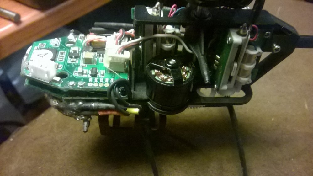

      Now isn't that the cutest little outrunner main-motor you've ever seen?

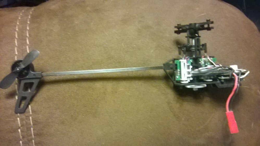

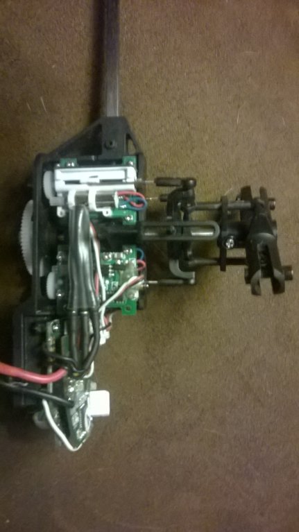

      These photos were taken after a complete frame/electronics swap using all the best parts on hand and refining the wiring. I had to upgrade a few solder joints here and there just for reliability's sake.
      I finally cracked the code somewhat with the Tx program. I now have full +/- collective control with throttle-cut switch in the usual location. I have yet to bring in the 3-way mode switch and throttle curves, but at least the thing is flying at a level where I can explore the capabilities without having to worry about weird control issues. :D
