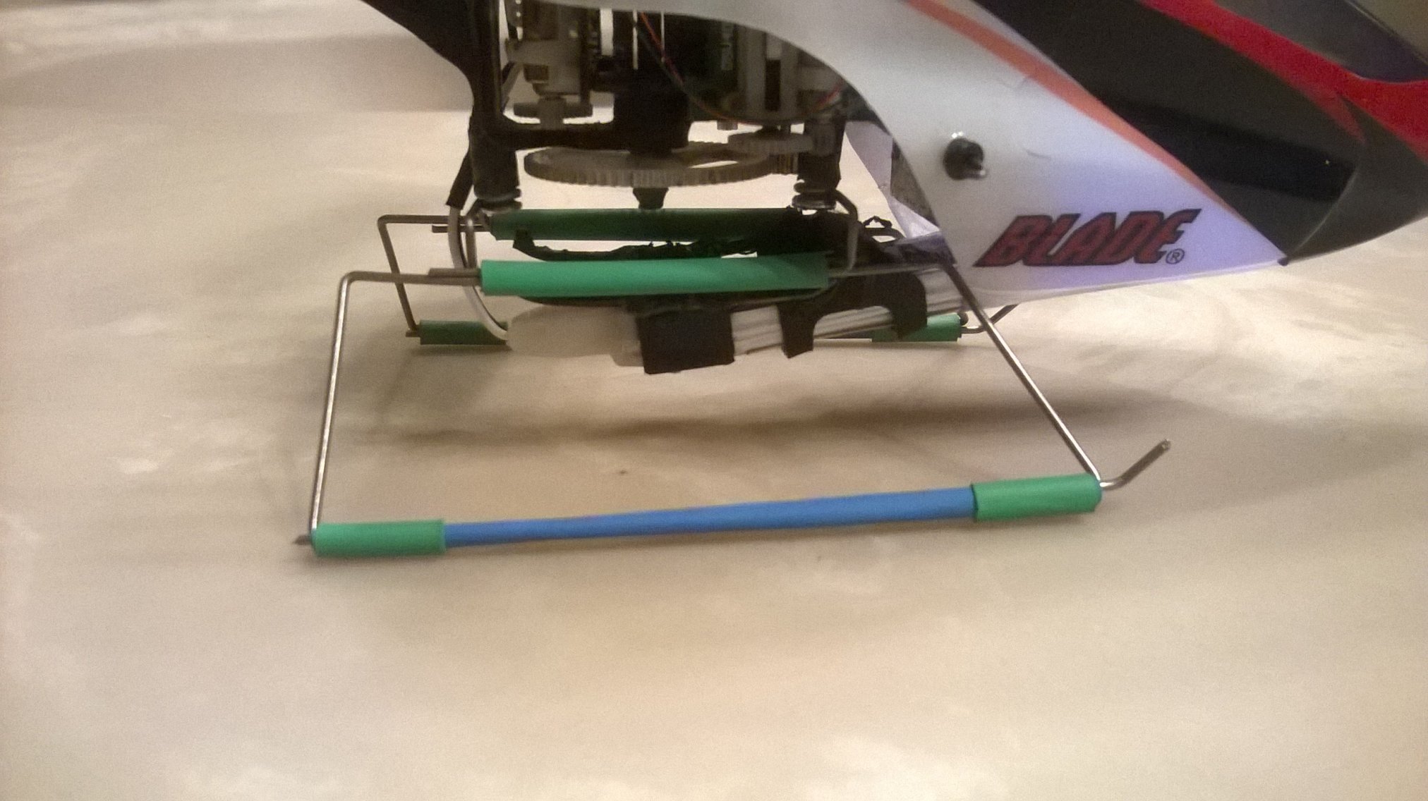

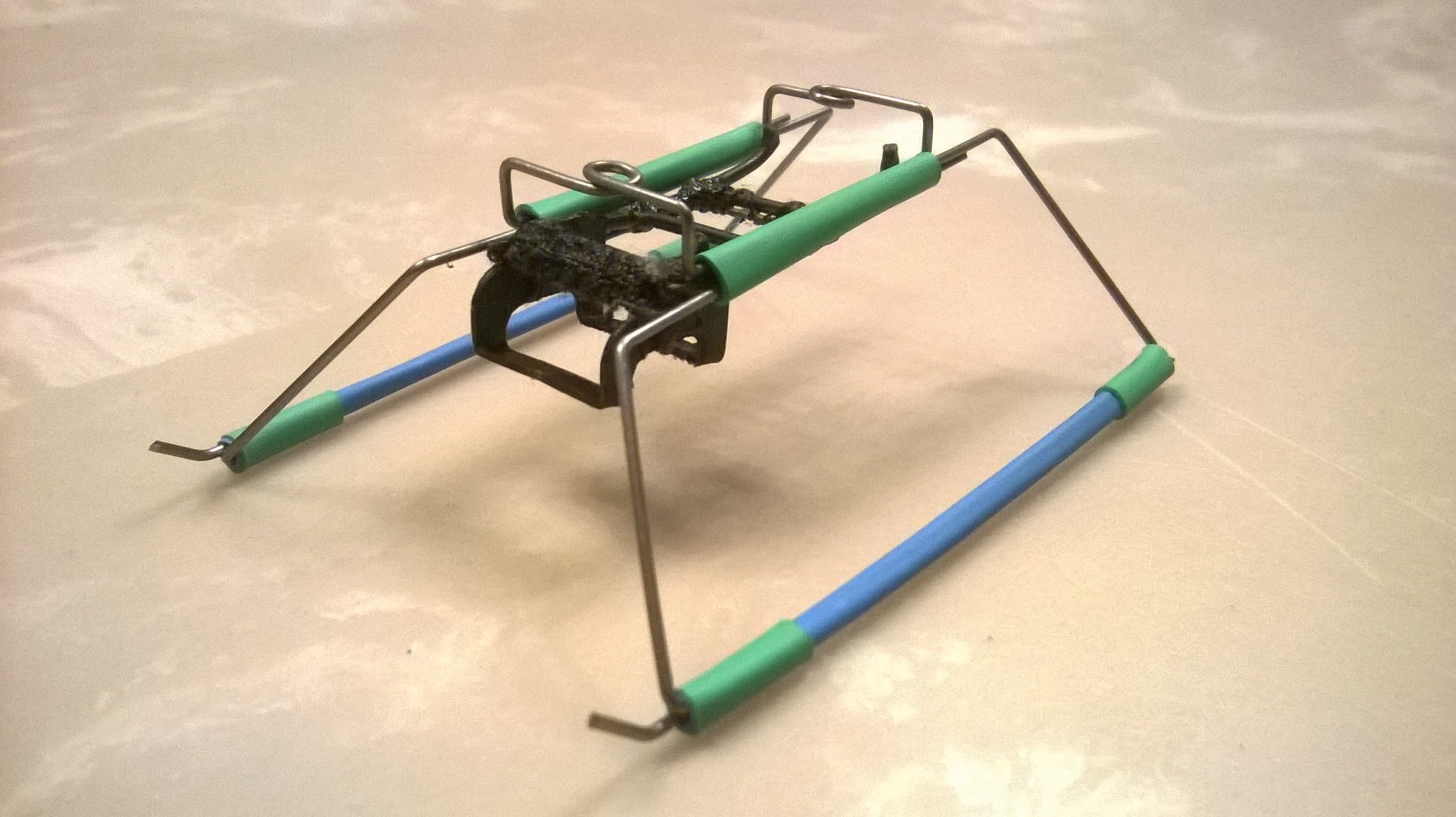

      Strange little bird, this Brushless Nano. I installed the new swash plate, then tried the new 200mAh Microheli packs, and same story-- "stop and drop" instead of soft-landing mode at LVC. All this with Nano in stock configuration.... right? I decided it a good time to build another prototype set of "indestructible" landing skids from 0.5mm steel rod. Finished and installed, I was about to flight test the Nano, and decided to try my modified mCPx blades again. Bear in mind that both of these changes add weight to the little Nano, so I expected no change in the "stop and drop" problem. stopwatch app armed and ready, I set a freshly charged 200mAh pack and took off...... 7 minutes later, Nano enters normal LVC soft landing mode. 2 more 200mAh packs later, normal LVC landings. Just for shiz and giggles, I tried a 180mAh pack, 5 1/2 minutes later- still another normal LVC landing. I'm assuming the slightly heavier steel wire skids and bigger blades added enough weight to change the voltage/current curve so that LVC voltage threshold is reached before packs are discharged beyond current capability. Bird is yet a little less twitchy as well. I can actually take my hand off the cyclic and scratch my nose without the Nano drifting away toward the nearest available wall. Higher disk loading and increased rotating mass stabilization? WP_20150603_002.jpg WP_20150603_003.jpg

      Yes, I may go with a slightly thinner wire on the next set of skids. I also need to work up a different battery holder instead of recycling parts from the stock plastic skids. This is only the second attempt at it. The first one I made a few months ago was similar, but I scrapped it thinking it was too heavy. Turns out, the main motor was going out instead.

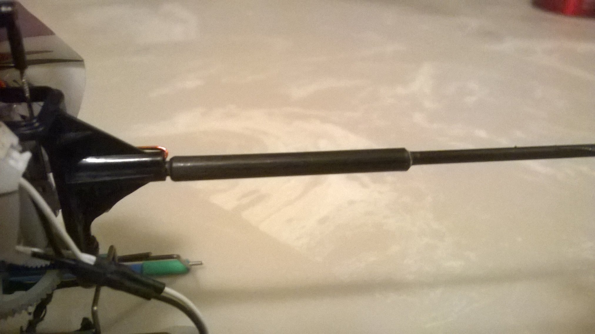

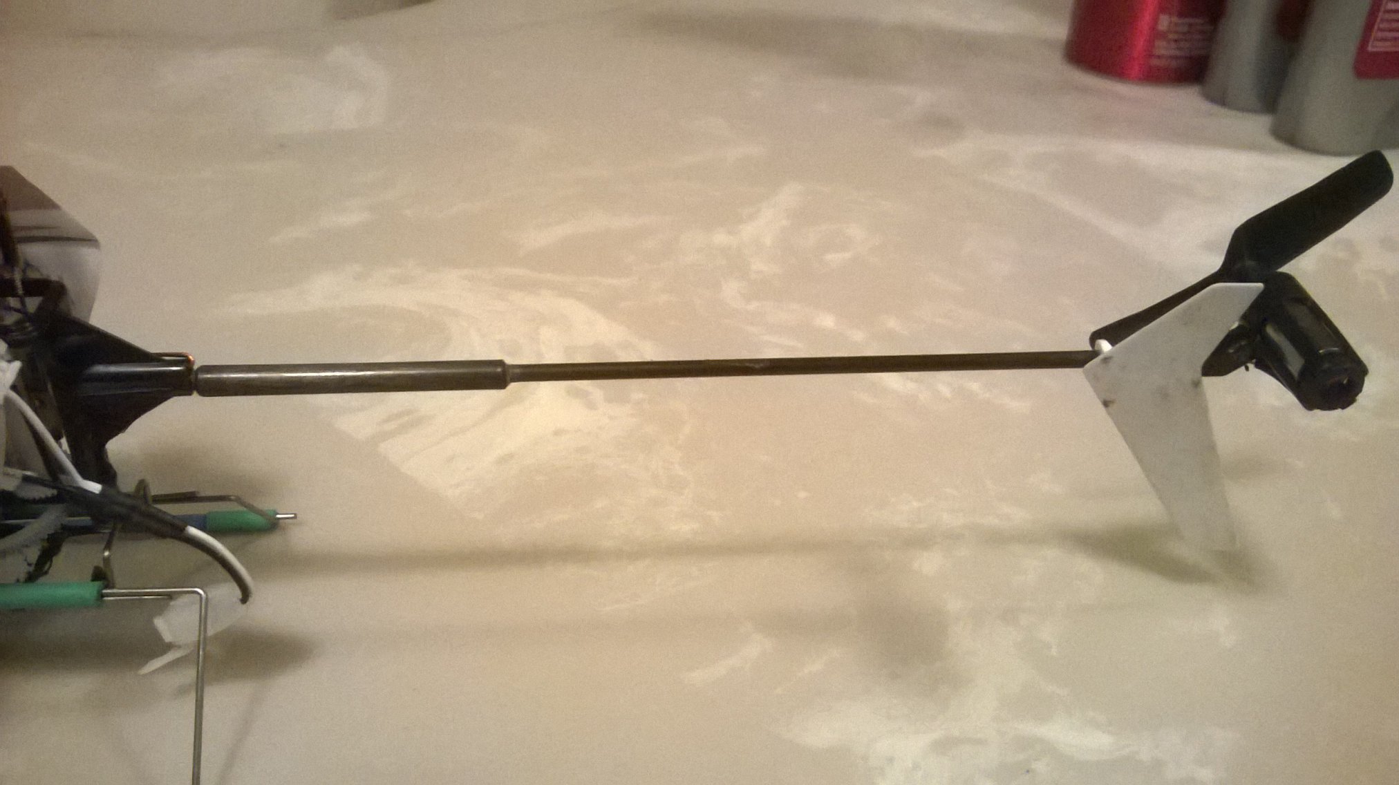

      WP_20150607_003.jpg WP_20150607_002.jpg 26mm CF tail boom extension. (What can I say... I couldn't help myself from it.)
    12. Beaver
      4 packs worth of flying in the wind, the tail boom extension seems to be working well. The "stop and drop" problem has returned, having gone back to stock 85mm bullet blades. The modded mCPx blades I was using (with no stop/drop) are damaged due to a little help from @Crash Heligod, who showed up and gave the Nano "a little push" right into a steel post yesterday..... broke the eye out of the grip on one of the blades, and demonstrating how brittle they are compared to stock blades. Since the BL motor and ESC seem to behave better with more blade, I will be ordering some 95mm blades tomorrow. I already had that in mind when I stretched the tail. :rolleyes:
