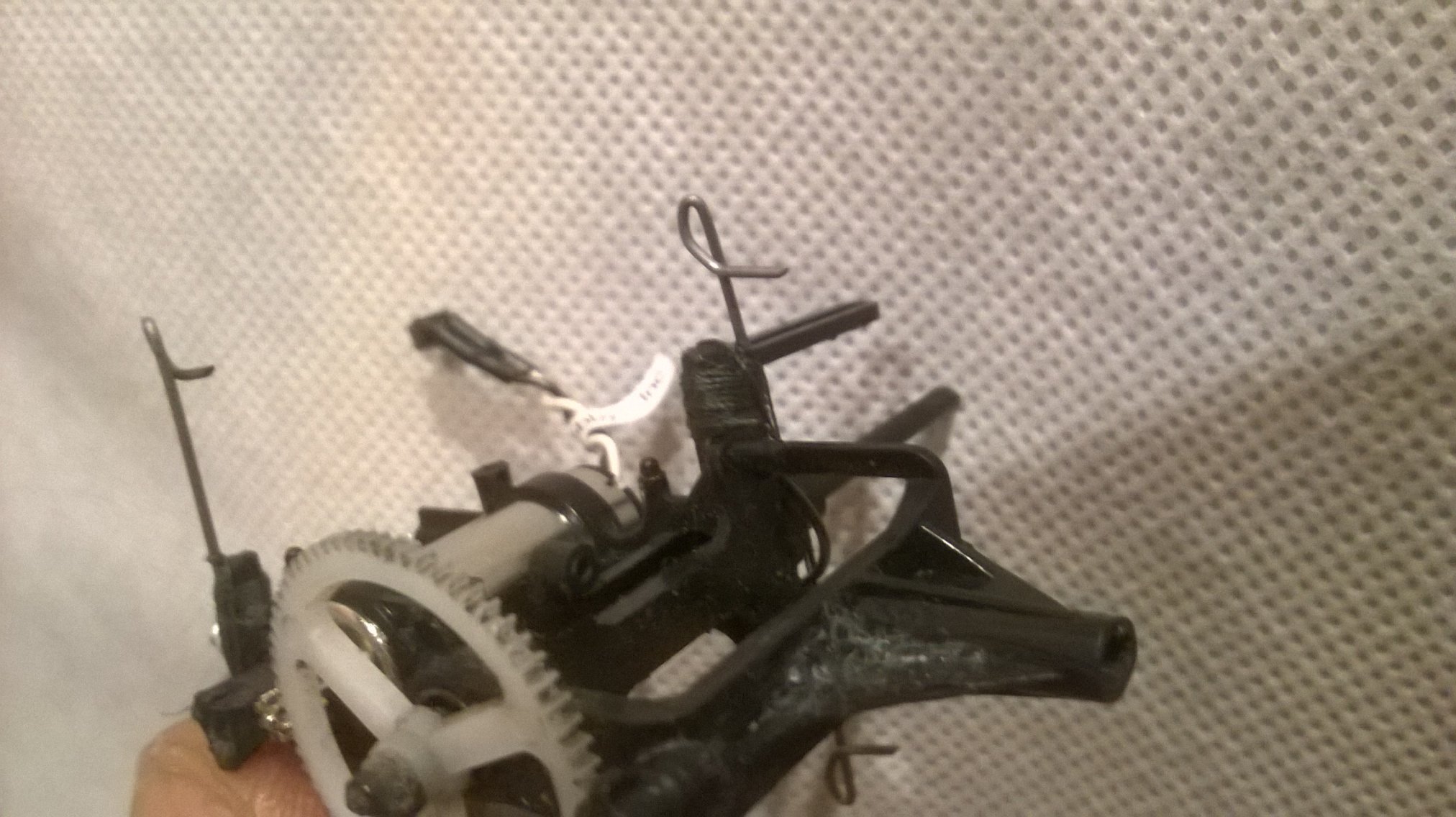

      WP_20150513_001.jpg Nano stripped down to frame! Time to repair broken canopy pins, and re-work LED configuration while I'm at it.... wiring could be done a bit cleaner, maybe add more LEDs. I'll document the LED aspects for @Stuart this time around.

      I break frame pi a all the time, or I should say my dog does.. I use my nano to walk/run my dog. He chases it and periodically he gets it. And although I've trained him not to destroy it, his initial nip/take down usually results in a canopy or frame pin break. Interested in the suggestion of using a carbon fibre rod mod for canopy fixes.
      Stuart
      Citizen #507

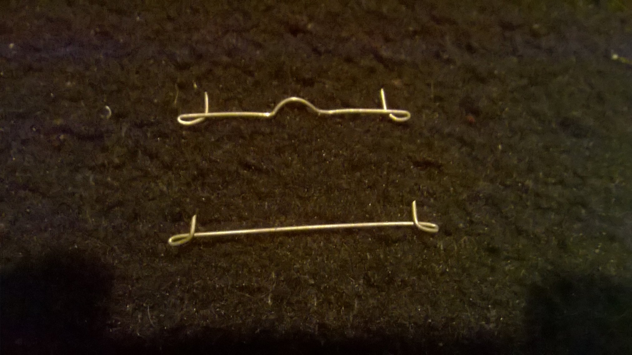

      Actually, I'm going to try using rigid steel wire of approximately .25 to .5 mm rigid steel wire. It's small, light, yet rigid with a bit of spring to it. I've also been experimenting with landing skids using same wire, but I haven't quite perfected it yet. I'll document those mods as well as I go.

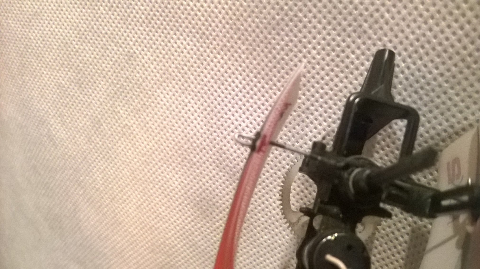

      I an using steel wire at slightly less than 0.5 mm diameter. Form two wires as shown, one bent in middle to clear main shaft. Fit eye ends so that they fit slightly tight inside canopy grommets. c3.jpg
      Verify correct location and fit for canopy, then bind wires to frame with cotton thread at old canopy pin stubs, wrapping thread tightly to hold wires in place. c4.jpg
      Check canopy again for correct fit, then apply light coat of CA (or super glue) to thread to seal thread and make binding permanent. This process is similar to fiberglass, providing a solid reinforced bond around frame and wires. once CA has set and dried, wired can be gently bent if needed to finalize correct fit.

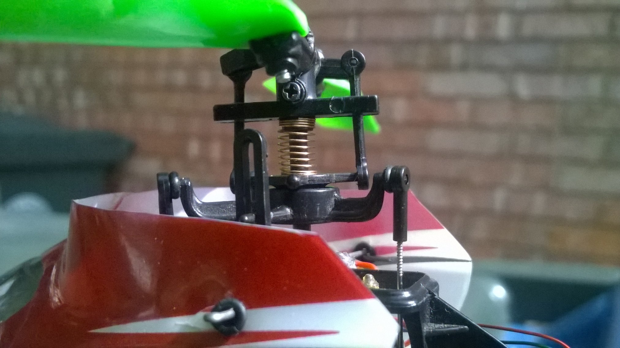

      WP_20150514_001.jpg So after assembly, with fresh tail-boom assembly and main motor, I spooled up the Nano for a test flight and it was back to the toilet bowl effect. ...... Upon closer inspection, I found that I had forgotten to install my "swash plate spring". Two minutes later, after correcting my mistake- back to flat and stable hovering. That silly little spring really does make a difference!

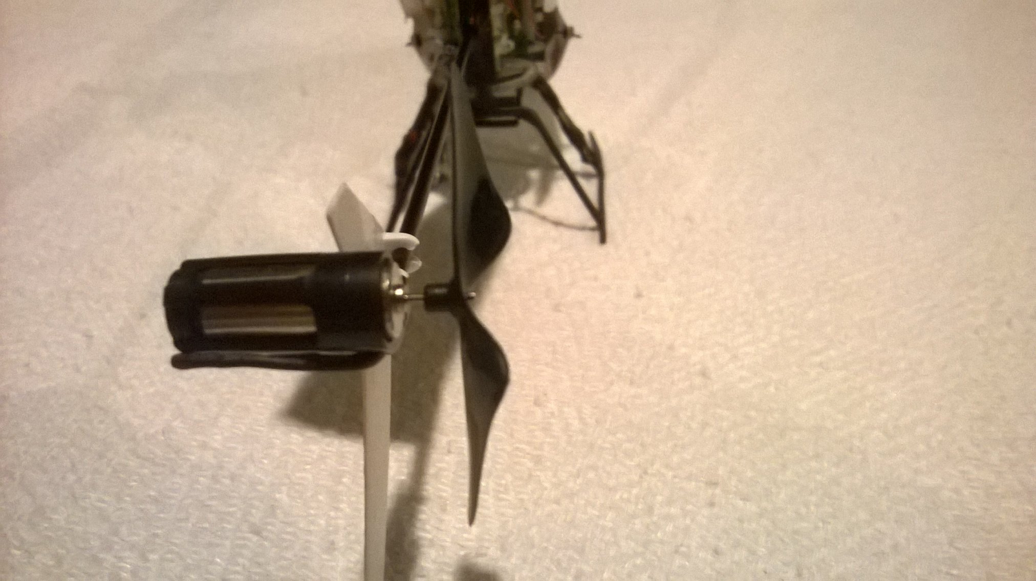

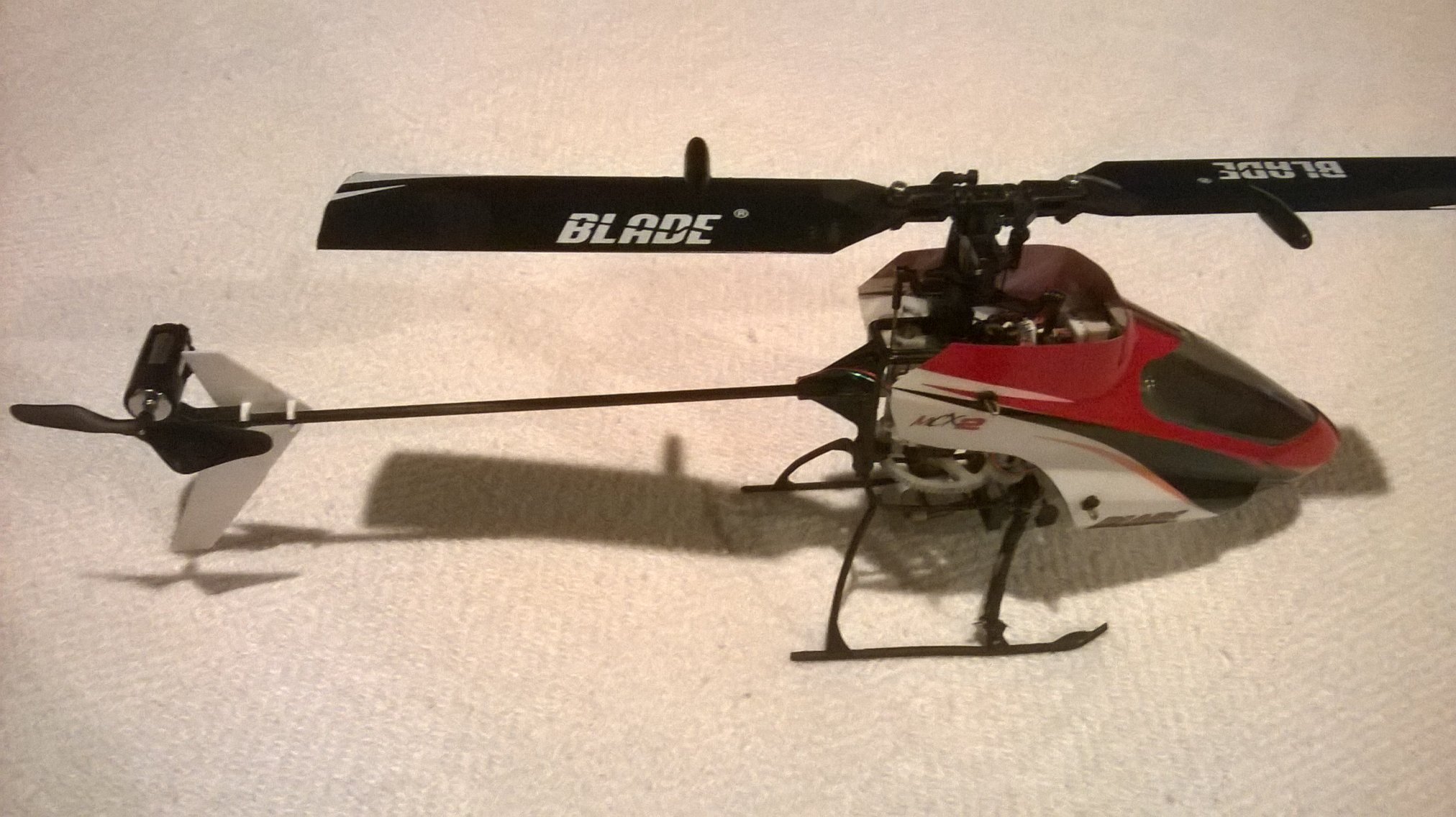

      I ran a series of test flights to "benchmark" the Nano for flight times, main-blades vs. battery packs. So far, on my newest packs (45C/180mAh) I'm getting an averaged 6.85 minute fly-time (getting 5.5 to 6 min. on my older packs), no LEDs yet, and getting best times using my modified MCPx blades that I've cut down to 85mm and reduced thickness of root to fit Nano grips. Also running slightly smaller tail rotor blade to get RPM up a bit on tail. Will run times again after LEDs re-installed. WP_20150515_001.jpg WP_20150515_002.jpg
