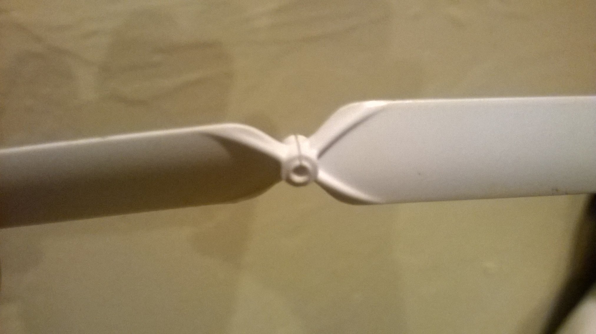

      WP_20150507_002.jpg Nope...... I couldn't leave it as is. I went by the LHS today and a set of mCPx bullet blades caught my eye. So I shaved the grip ends of the blades down to half thickness to fit the Nano grips, then trimmed length to 6mm short of stock blade length at leading edge tapering out to 2mm short at trailing edge. This little mod has further reduced some of the inherent"twitchiness" aside from all else I've done recently. The thing still has plenty of cyclic authority when I switch the Tx to "high rate" mode.... It's even beginning to sound like a larger heli when those fat blades go to making that whopping noise under hard cyclic! I took on a 35 to 40 kph wind with it earlier.... Fun!

      In my experience any modification increasing Nano weight deteriorates flight chracteristics.
      I use alu swash anyway due to much higher crash resistance.
      I may go for the AL swash eventually. I haven't really added much weight to my Nano, and it still has plenty of punch for it having stock br motor. Solid 4+ minutes fly time.

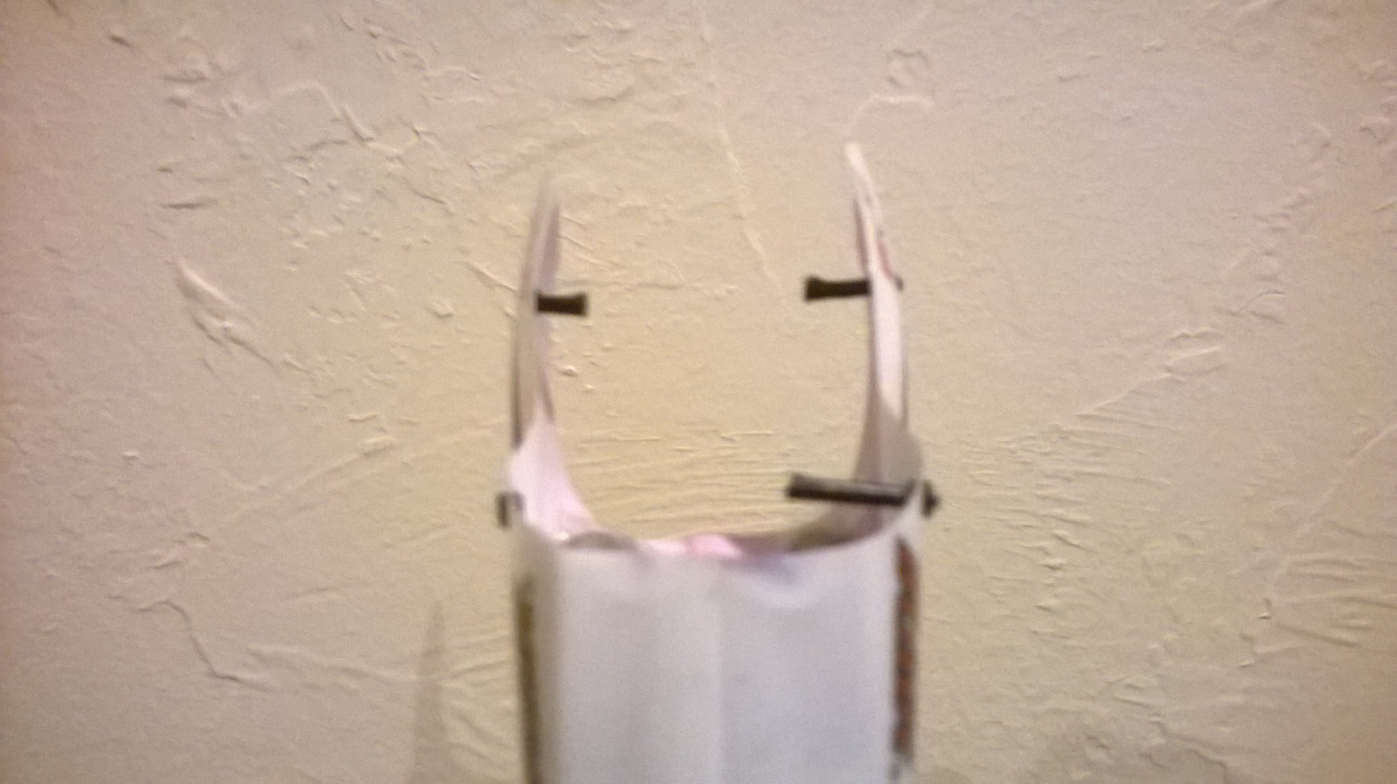

      After a solid week of severe weather (storms, tornadoes, flooding, etc) tonight turned out a nice calm evening for some night-flying, so I took the birds out for a run. As luck would have it, "You Know Who" must have decided it was time to pay me a visit just when I was practicing some inversions with the Nano. One thing lead to another, and I end up with 3 broken canopy pins. WP_20150511_007.jpg

      If I remember correctly CF frame for Nano is heavier than plastic.
      Low weight is crucial for Nano.
      Please try another solution. It is cheaper and will help you save lower weight.
      Simply get thin 1mm CF rod, cut it, glue it in place of canopy pins with small drop of CA glue. Your frame will become virtually and practicelly indestructible.
      Let me know if you want photos of this mod.
      One more tip... With hot wire or tip of sharp Weller soldering you can make "channels" for CF pins increasing surface for CF glue and final strenght of pin mounting.
      5 min job, easy peasy, fun, rewarding...
    18. Beaver
      That's the Nano in the indoor pic..... after the canopy pins broke off. The "night shot" above is the 120sr outdoors at about 60m up, making it look smaller.
