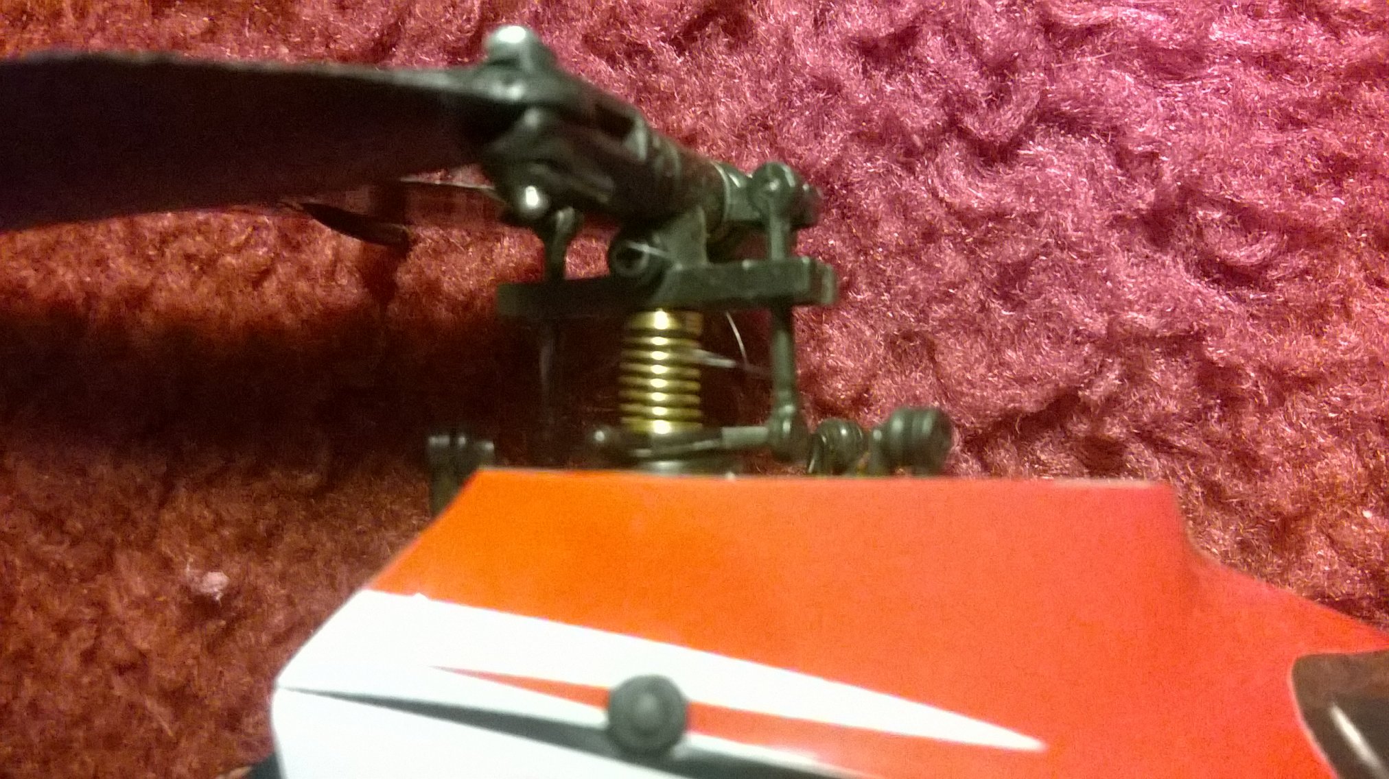

      Ain't that some shiz. I've been flying the Nano for quite a while since replacing the F-spindle, but the silly thing just didn't seem to like holding a stable hover.... so I dismissed the problem as being the Nano's inherent twitchiness and left it at that. Then recently I read about a similar problem in another forum. Long story-short..... I had the damn F-spindle too tight. Duh! (insert palm-face here) 1/4 turn loosened, and the silly thing hovers flat on its own now. I can even piro now without it going out of control. Go figure.

      Probably need to replace the spindle on my nano. It hovers with a toilet bowl effect.. But I could never be bothered looking into the problem. Now I can just try your recommendation. Thanks.

      That was the problem I was having. Seems the least little bit of friction at the blade grip (spindle) causes the servos and gyros to overcompensate, resulting in T.B.Effect. I should have known. So loosen the spindle just enough so there is no resistance at blade grips while maintaining minimal gap between grips and rotor head. (A dab of threadlock on spindle nut recommended) I also installed a lightweight spring between rotor head and swash plate to minimize slop. The thing hovers virtually hands free now!

      To further update: Having solved the stability problem at the F-spindle, I can actually fly with a 25kph wind and keep the little shiz in the air now! :D

      Spring mod is very interesting.
      I wonder if simillar spring could be beneficial in 700-800?
      I am not pursuing more stability but precision of control could be the main benefit.
